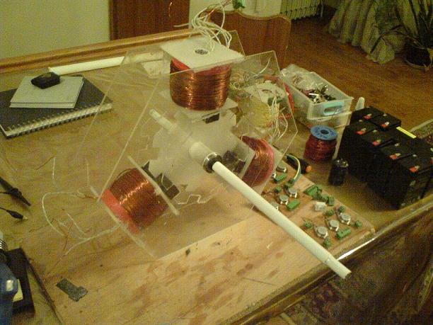

Hi everyone,
My tri-coiler SSG is almost complete, so I thought to share a photo of it. I ran it with two coils, because somehow four of my transistors were blown out. Some the 2n3055s were different in labeling and those were the most vulnerable ones! I saw some Toshiba 2N3055 transistors with higher price, maybe I'll try those ones. Any one has any recommendation for transistors? I have not competed the magnets on the wheel, and I'll add 6 more double stacked magnets on it, also I intend to add three more tri-filar coils with #18 wire to it. My Battery is also unable to power this with three coils, so I want to buy a good battery with more amp-hours. I have to say that running it with 18 volts was really great, it produces significant amount of radiant energy and torque. Any suggestions?
EliasLast edited by elias; 01-19-2008, 03:02 PM.
The three coils cost me about 100$. Each of them weighs about 2kg. Thanks for your encouragement.Originally posted by Jetijs View PostElias, your setup looks very good. You have three big coils, how much $ did you spent on that? I hope it will perform well for you

Elias,
Motor looks great!
MJ21194 are great transistors for these circuits.Sincerely,
Since I have been using my zener diodes, I have been able to use these cheaper transistors.
I like the D44VH10, 80 volt, good for switching up to 5 Amps, Gain falls to zero at about 50 MHz. Lots of current gain (I have run these with 2k to 4k base resistors).
Designed as a high speed switching transistor for switch mode power supplies.
I have been using these and they Rock. But be sure to protect them with the zener modification mentioned earlier.

Thank you all for the transistor recommendations,Originally posted by theremart View Post

Elias good work on your setup. Let us know how it performs. Remember you can hook up some of those 7 amp hours in parallel to effectively make a larger bank of amp hours if you cant afford a larger battery just yet. I think that some of bedinis designs actually have the two coils in series. There may be some advantages to this for some designs. The mj is an excellent transistor for a higher am draw setup. You can also get the equivalent in a to3 (think 2n3055 housing) case. These are the mj15022 i think. The mjs are a bit pricey so make sure you get your circuit down pat. Also check out this page before you buy some Counterfeit Transistors
