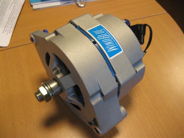

I should receive this week the wind generator alternator I intend to have the SSG turn the alternator for additional output. This may be fool hearty, but since I can now turn the wheel at over 2,000 RPM with 2 coils, I am hoping I can at least get 1,000 RPM with the generator. I am excited

But don't have too much hopes for the wind generator/alternator. Today I received mine and it is hard to turn the shaft. I had some usual alternators before and they were easy to turn in lo load conditions, but not this permanent magnet alternator. This could be due to the strong magnets and the drag from the copper coils, I don't know if that is supposed to be so, I emailed the seller about this. Nevertheless it generates very well. I don't think that your SSG will have enough torque to turn such a generator (as in picture), because my 6 coil/transistor SSG certainly is not able to turn this generator maybe a big flywheel would help a little.

Heh, I really should read the instructions or manuals first
Here what it says:
"It is normal in the first few hours of use to hear some clicking sounds when the alternator is turning. This is due to the close tolerance of the rotor and stator assembly. Also it may feel somewhat hard to turn the shaft by hand, but as the bearings "break-in" you will notice that the alternator will start to turn in much slower winds. This may take several days of use depending on your local wind conditions."
