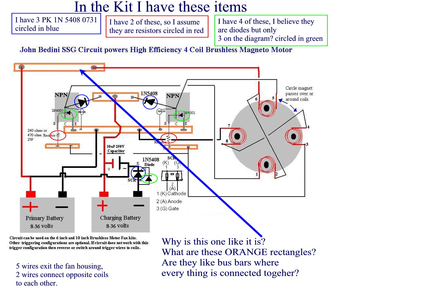

    Looking at the circuit layout in BrushlessEnergizer1.jpg (BEpic)
    I see only 5 wires exiting the fan housing, is this correct?
    8 wires, 4 start/end pairs for each coil.
    I count a total of 7 new wires added inside the fan housing,
    2 connecting opposite side coils and 5 leaving the fan
    Is this correct?
    I have 2 MJL21194, an internet search tells me the
    TIPO of MJL21194 is NPN and the P/OUT
    1-2-3 is BCE. Now I know the MJL21194 is the NPN
    on the diagram (BEpic).
    Question: BCE (pins) are left to right with the
    label MJL21194 upwards and readable, Correct?
    I have 1 2N6509G, an internet search indicates, to me,
    2N6509G is the item marked SCR (K,A,G) in circuit?
    I've attached Questions.jpg that have a few questions
    about BrushlessEnergizer1.jpg.

      Randy, thats a buss bar i think..

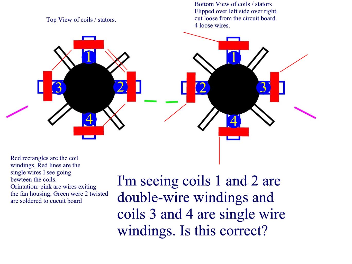

          Still confused
          I cut the circuit board loose, one wire broke loose
          after looking at it for so long.
          I believe I'm seeing, on my fan:
          two coils at 90 degrees have double windings
          two coils at other 90 degrees have single windings
          Is that normal, is that expected?
          Am I wrong?

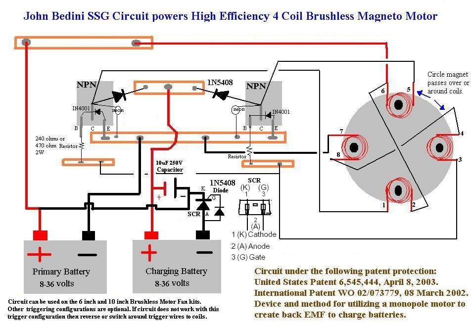

          One Schematics shows working with 8 wires,
          5 leaving the fan housing (I think) and another
          shows 4 wires and 4 leaving the housing.
          I don't understand what to do with my wires
          start cutting wires to make 8 or use the
          4 I have?
