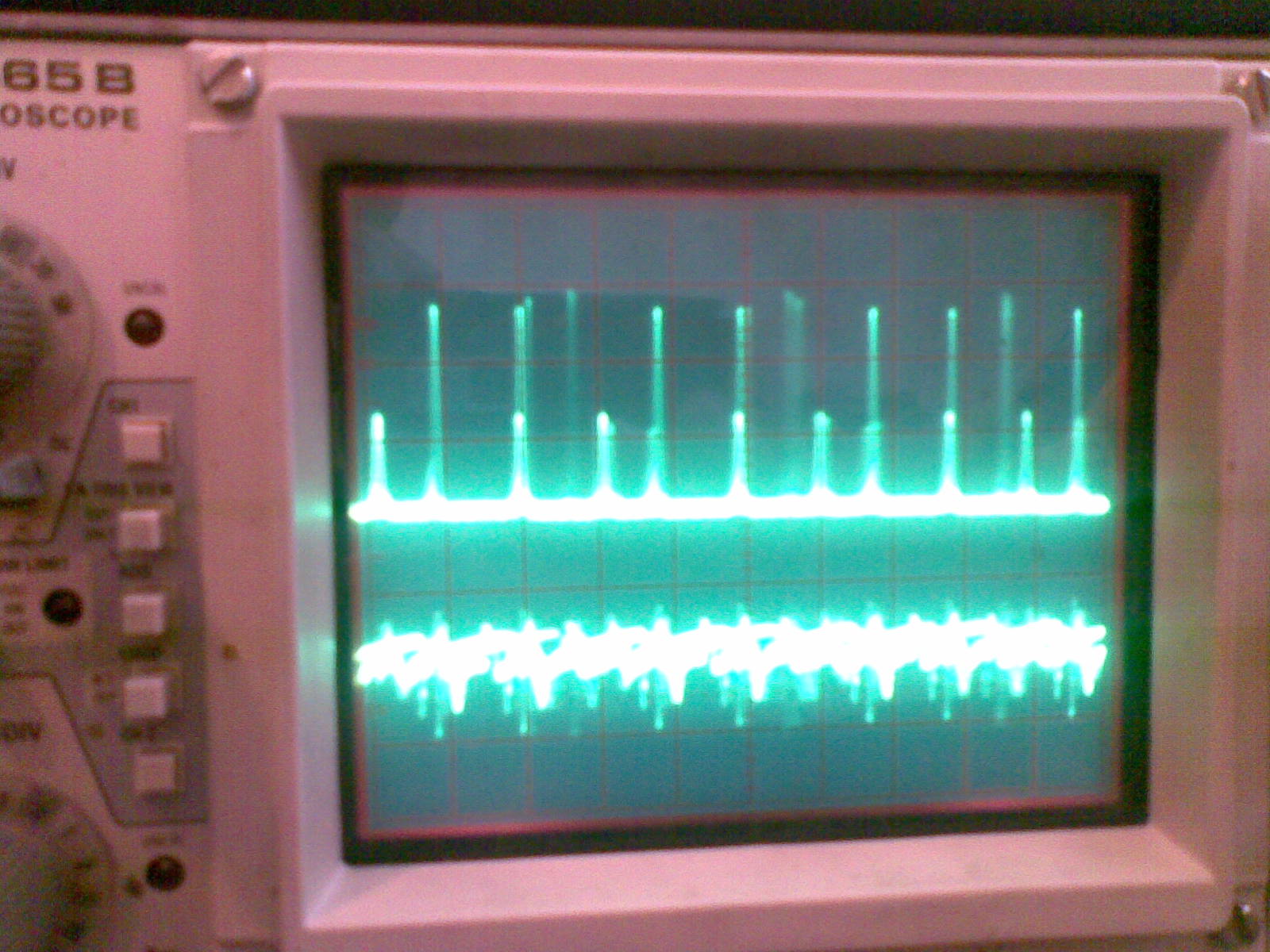

      • energy calculations in Ainslie circuit - conclusions
        Hi all.
        in my last 3 thorough experiments i measured:
        1. the total *energy* consumed by heating 650cc of distilled water by my load resistor (Harvey - sorry, my mistake - its really made of Teflon...), insterted in an insulated plastic thermos. i used mercury thermometer (accurate by 0.2 degrees - celsius) since the digital thermometer was not stable because of the RF emmited by the resistor (i assume).
        2. the total *energy* drained from the 12v batteries (i used 1 12v for the 555 circuit, 1 12v for the load resistor circuit), measured by a digital charger that shows the total MAH used for recharging the battery to 14v from its current state.
        the waveforms were pretty good (see attached) in all these experiments.
        the results were BAD though (no energy gain):
        1. water heated to 10 degs. above ambient (24-34 celsius), with counting the energy needed to heat the load resistor too (C teflon=1.09, C water=4.186) and with calc. the energy needed to preserve the heat during the test (1 degs per hour) = overall 30 kilojoules (KJ) energy.
        2. battery: 1200 MAH charged, 12.5 volts avg. during the test = 54KJ. even if we drop the part of the MOSFET heating , we reach 38KJ (although it breaks the logic behind the energy consumption which suppose to incl. total waist, not partially)
        so my conclusion for now is that i do not see any gain here !
        BTW, the 555 battery gives about 10% of the energy to the system ! (measured by charger also) - there is absolutely energy pass from the 555 to the load, though relatively small, but significat.
        but i'm still not giving up, and i think of 2 possible ways to overcome this (for now):
        1. use 24v for the load - maybe we have to pass some voltage threshold in order to get the effect. currently i get peaks of 170-200v with 1 battery, but with 2 i could get 400-700v.
        2. maybe the waveform was not good enough, although it seems i cannot get better than i already got. i tried many configurations (adjusting the 3 potentiometers)
        note that i emphasized *energy* and not power (watts), since energy is the right way to measure the possible gain in the system.
        i would like your help in this process, so suggetions please...
        Gad
