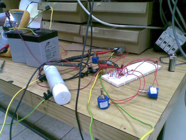

                    • finally - my experiment results
                      Hi all.
                      finally i got the load resistor built and bought a high voltage probe (specs - as i wrote before).
                      Experiment description:
                      load resistor (see image) - NiCr 80/20 wire, gauge 20, spacing of 1-1.5mm between each wire. using teflon rod, diameter 34 mm - but with a carving of 1mm depth - so inner diameter is 32mm. 48 turns = 10.5 ohms resistance.
                      MOSFET - i glued a heatsink to it (not shown here) - taken from an old pc motherboard.
                      Wiring - Power circuit : 1.2m x2 between 24v batteries to load resistor and to the shunt, approx. 14 gauge wire, single copper thread (standard power electricity wire used for 220v in your house, i think). other wires are 10-35 cm (not shown in the images).
                      555 timer circuit: 24 gauge wire, single thread.
                      scope channels (see in the images):
                      ch 1 = MOSFET Drain leg (load resistor spikes).
                      ch 2 = gate pot. leg to 555 (the 555 output signal)
                      experiment process: first of all, in order to get the required 3.7% duty cycle with 2.4khz base frequency, we disconnected the power circuit from the 555 circuit. otherwise - we could not reach under 8% duty cycle !
                      after disconnecting , we managed to get about 3% duty cycle and 2.4 khz freq., using the following potentiometers values:
                      2k ohm pot. = 194.5 ohm (called the "duty cycle pot.")
                      10k ohm pot. = 9.87 kohm (called the "frequency pot.")
                      100 ohm pot. = (called the "gate pot.") - value does not matter at this stage (since the gate is not connected to the 555 timer circuit) ! we'll deal with it later on.
                      after getting the required freq. + duty cycle, we connected the power circuit to the 555 circuit, and adjusted the 100 ohm pot to its lowest value (almost 0 ohms). the spikes on the load resistor were the biggest. after tuning the gate pot. to 0.8 ohm, we got about 420 volts (see in images - ch 1) and we got an instant self oscillation of ~318 khz !! we also got a lower spike in the same freq. of about 150 volts (see in images - ch 1 too).
                      the 555 signal was distorted due to the oscillation - we think (see ch 2 in the images).
                      so thats it i think. but i did not get any "aperiodic oscillation" (to my knowledge...).
                      what is the next step in order to get ready for the energy measurement and expecting COP > 1 ?
                      how to get the aperiodic osc. ? is it needed or what we got is enough ?
                      thanks to you all for your kind support,
                      Gad

                        Gad - very well done.
                        All the above is good. Not sure that the glued fet will hold under operating conditions. Our experience is that this can get quite hot.
                        Gad
                        I'm still not sure how you adjusted the duty cycle but what's wonderful is to see that it went into it's own required resonating frequency. Very well done indeed Gad. That's the whole object of the switch is to let the system find its values. You can't really impose this.
                        Now you need to do detailed measurements across the shunt to determine the amount of energy delivered by the battery. And you need to assess the amount of energy dissipated at the resistor.
                        I should be available most of tomorrow. Well done Gad. If you can call me tomorrow I may be able to get a conference call going.
                        • Hi Gadh,
                          Nice to hear you made it too. I guess you now have about the same situation I have. The only big difference is that you got it into oscillation with that base frequency of 2400Hz. I did not succeed at all with that low base frequency and had to go much higher before I got my circuit swapping over to that other much higher frequency 'automatically'. (After adjusting the pots a little) The biggest difference between your and my setup is the diameter of the coil I think. I only have 28mm. I hope I can find some time this weekend for a few measurements.
                          Cheers,
                          B
                          • Bart, maybe another thing you need to check - first disconnect the 555 circuit from the power circuit, adjust the base freq. and duty cycle as Rosemary suggested, only then connect the 555 circuit to the power circuit - and adjust only the 100 ohm (gate) pot. to some low value (closest to 0 ohm).
