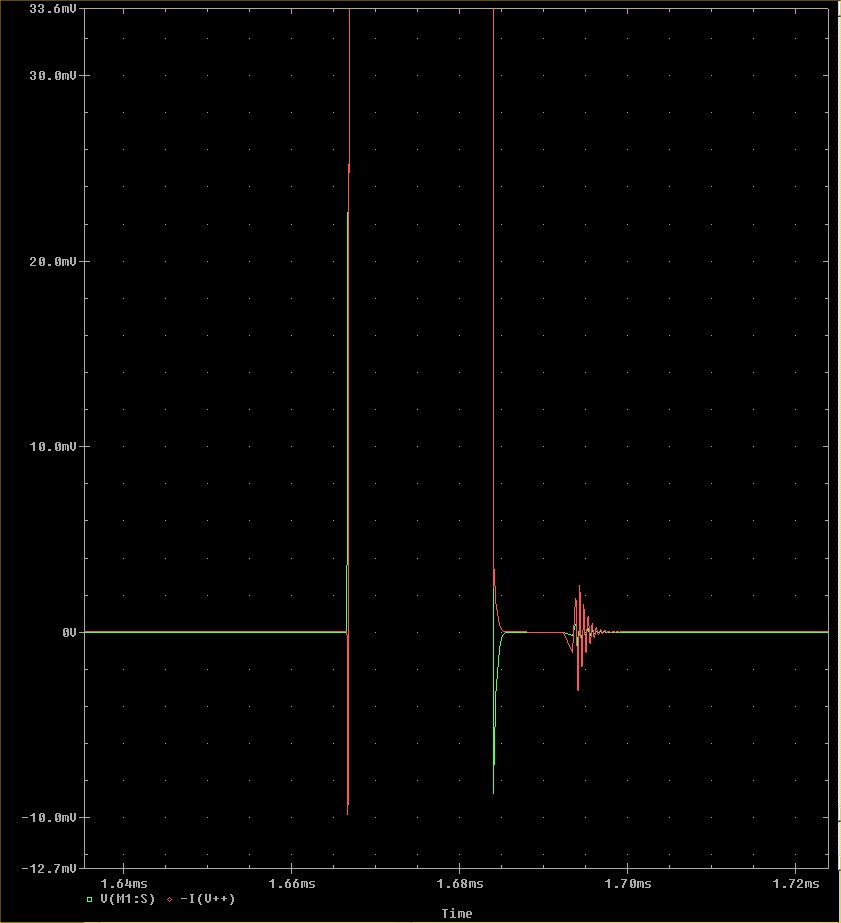

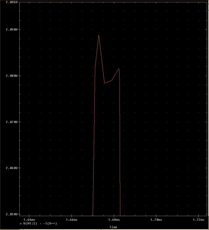

                            • Shunt Voltage Spike vs. Battery Current
                              OK,
                              Going back to my post of stating I believe no current goes back to the battery in my sim (or Aaron's test), even though we see a nice single clean negative spike on the shunt resistor, here is what I found. Refer to the two attached scope shots.
                              In the first we see in green, the negative voltage spike on the shunt resistor very similar to what Aaron's scope shot looked like. The red trace is the battery current. Notice there is no corresponding negative spike of current going back into the battery, however notice the short red spike on the leading edge? That's the effect I described before when the flyback diode is present.
                              The second scope trace just shows the very top of the current pulse sourced from the battery, also no spike of any kind there in the trailing edge.
                              These traces made with 100 Ohms gate resistor.
                              .99
