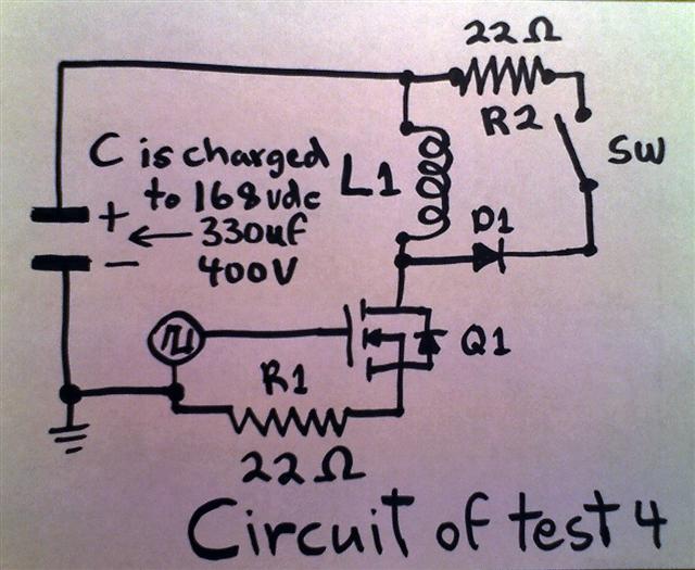

                        I thought you were asking about the circuit in the new video! I now see you were inquiring about test 4 video.
                        I made a schematic of test 4 circuit. I also just saw for the first time your schematic. Looks like the same thing ... the only difference is your flyback is created by the small inductance of a heating element and mine by a coil. My original circuit was less the resistors as I was demonstrating the effect of just flyback re-circulated to the coil that created it. I added the resistor after seeing your topic to see how it would perform. I think it's doing very well at producing heat also.
                        Anyways, you should see the circuit attached below.
                        Luc

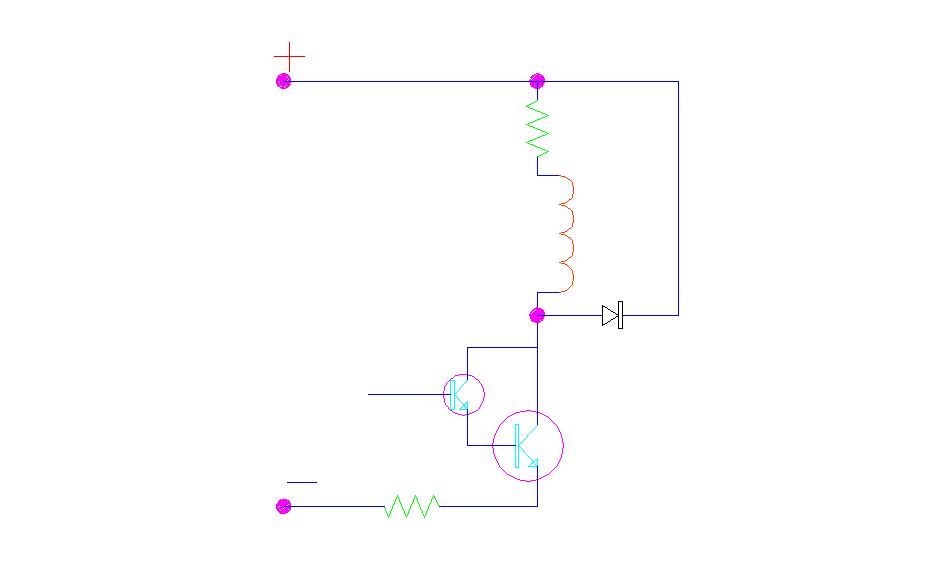

                        • Hi folks, Hi gotoluc, I did not realize that is the way you had the output resistor within circuit gotoluc. I was using Rosemary's circuit which does give more heat because I tried both ways although not sure if the coil field would reduce. Here is a cad pic of the circuit I've been using, which I believe is the same as Rosemary's circuit.
                              Hi SkyWatcher,
                              humm... you're right!... I see now there is a very big difference. In Rosemary's circuit the resistor causes resistance during the on pulse, which means it will be heated by the supply energy and then heated by the flyback when it switches off. In mine, I only wanted the flyback to go though the resistor.
                              Wow SkyWatcher, thanks for bringing my attention back to this since I thought that both circuits were the same.
                              If I were you I would think about this as you maybe getting more heat in Rosemary's circuit but if you think about it you are paying for it since it comes directly from the power supply during the on cycle.
                              I chose not to do that since flyback effects is what I've been studying.
                              Anyways, do what you think is best.
                              Luc
