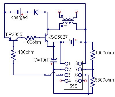

            • Sucahyo,
              I used to have an old RS NiCad charger. I opened it up to see how they did their circuit. Inside there were two components, a low current (microamp) lamp and a diode. This was connected directly to the AC line cord. !! At, any rate, it would have 120V+ when no batteries were in there. But when the batteries were installed it would drop all the voltage across that lamp.
              So, as far as your circuit goes, if the output impedance is high enough and the current is low enough, the spikes will be dropped across that impedance and the battery will charge to its desired value. Don't try this with LiPo's .

                  • Originally posted by Harvey View Post
                    Thanks for the answer . Currently have 400mA when charging two nicad, voltage is measured 0.1V above battery voltage with input current at about 2Amp at 10V. Since the battery and almost all component stay cold, I have a feeling that the frequency my circuit run is something that should be avoided for Rosemary replication.
