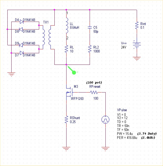

possible substitution for IRFPG50
FWIW, I wonder if the IRF842 would work. I happen to have a couple in my spare parts bin. They are repetitive avalanche rated.
IRF842 Datasheet pdf - N-CHANNEL ENHANCEMENT-MODE SILICON GATE TMOS POWER FIELD EFFECT TRANSISTOR - Motorola
"http://www.datasheetcatalog.com/datasheets_pdf/I/R/F/8/IRF842.shtml"
I'm no expert on reading the datasheets, but the only significant difference I can see is the PG50 is rated for 1000v and Rds@2ohm, and the the 842 is rated for 500v and Rds is 1.1ohm.
I know I could simply plug it in and try it, but alas, I have no oscilloscope and I wouldn't be able to confirm it anyway. (sigh)
-kent
