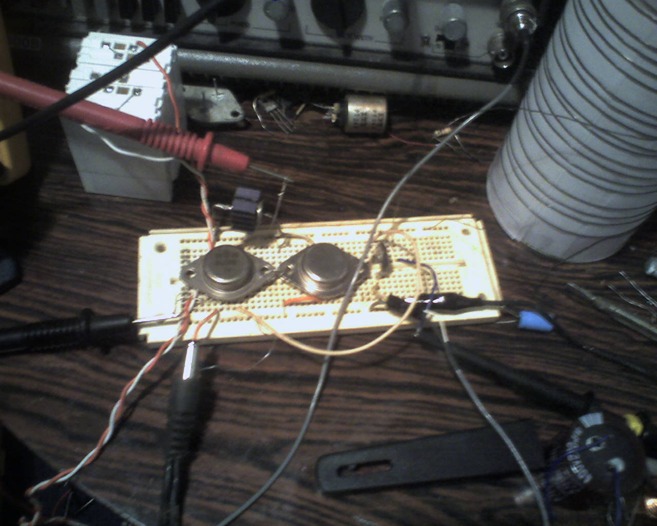

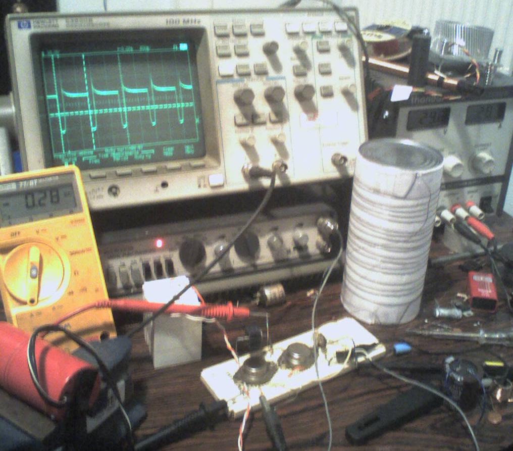

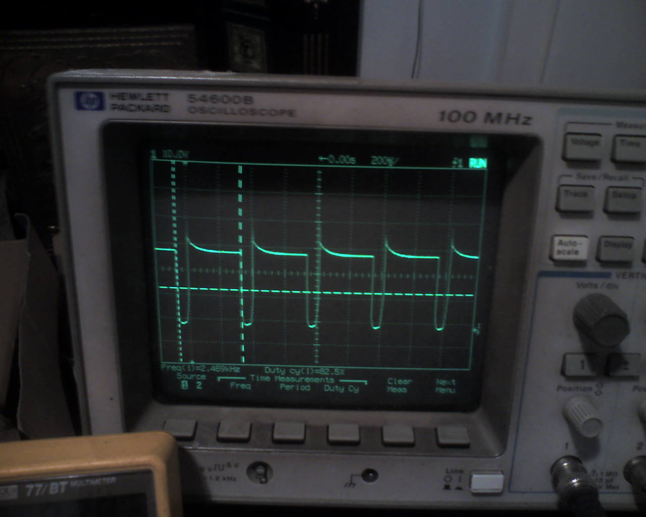

      While waiting for my mosfets, I decided to try out a couple of BU208 high-voltage bi-polar transistors in Darlington configuration and was quite pleased with the result - very good sink-time at all frequencies, though they have nowhere near the current handling capability of the PG50's. Rated at 1500V BE, they should also hold up pretty well to spikes.
      @Aaron - interesting to read that it's the "original" Ainslie circuit that only seems to produce the aperiodic waveform. While my BU208 circuit seems to produce a far better signal than my lone PC50 mosfet did, try as I might, I cannot get it to do anything unusual - so I'll probably knock up the original circuit tomorrow. I didn't see the point till now as my function generator can easily produce waveforms with a M/S ratio of 0.5%, but maybe there is something 'different' going on with that circuit! Only one way to find out...
