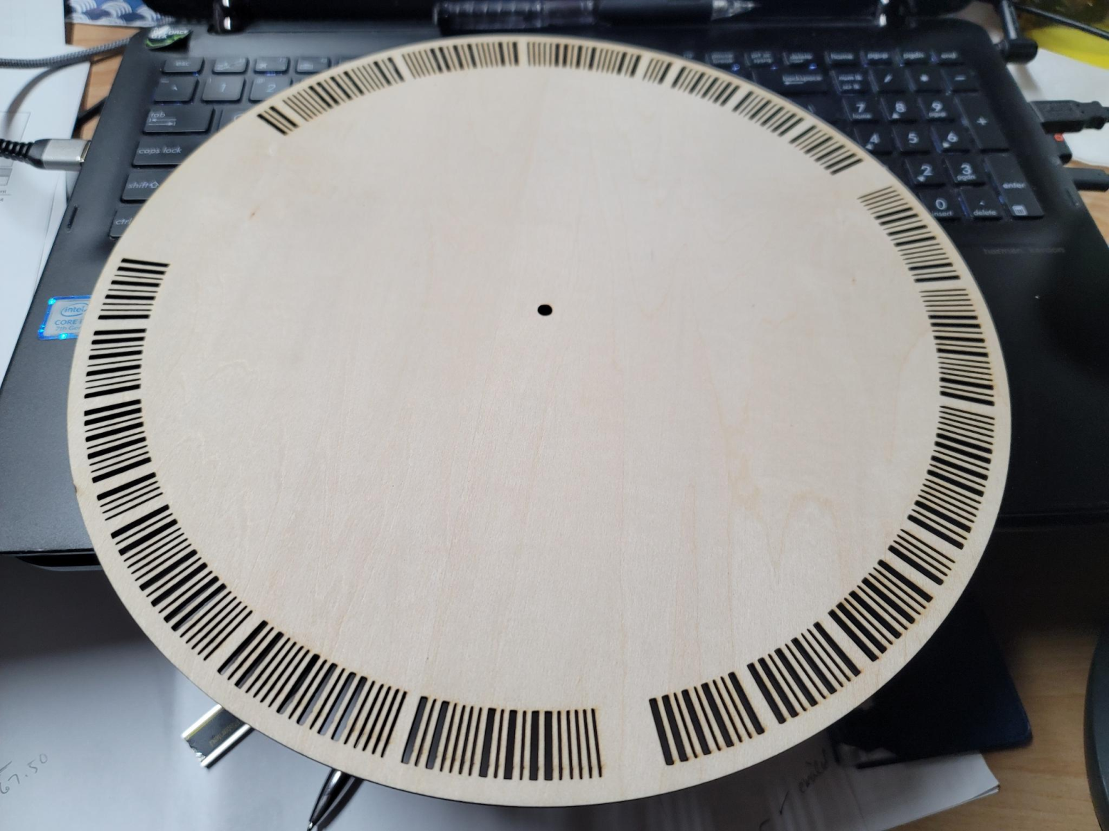

    I made a code wheel with my laser engraver but ultimately, it should be metal or plastic, but this will work for now. It will be hooked to a stepper motor (in all my spare time) and will rotate roughly at about 1 rotation every 90 seconds. I'll have an opto switch at the perimeter but the border is a bit too think and the switches aren't deep enough to reach the slots. I'll try to see if I can use the engraver to cut the circle a bit closer to the slots to give maybe 1mm border - otherwise, I'll use a separate IR LED and sensor and make their own holder so depth isn't an issue.
    The outline circle is not perfectly concentric I can see - will have to adjust that and make another if necessary. Still getting used to svg files in inkspace but that free program is way more capable than many paid programs.
    The sensor will trigger a transistor that will in turn control power to a relay to send the morse code into the transmitter. I should probably have some extra holes around the central hole to mount some kind of 3d printed collar around the shaft that locks onto the wheel from both sides. I'd like to have a smaller wheel but the dot slots would be way too small - they're already .03 inches as it is. The dash slots I tihnk are .07 inches wide. I should engrave the message on the face of that wheel as well just for identification. I should also have a curved arrow showing the direction it should spin - in this picture, the message starts at about 10-1030 and goes clockwise. The message is discussed in the video in the first post.
    A purely mechanical variation is better if it had a spring loaded metal contact that hit shots that were either like this or at 90 degrees more like a record, it would be more bulletproof but I only have so much time and this is about as bulletproof as it needs to be. It will be more reliable than a software programmable beacon that can glitch.
