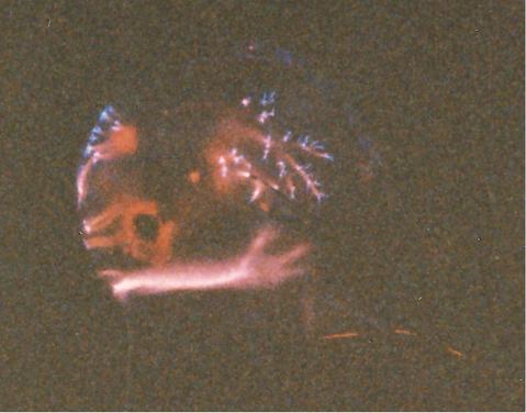

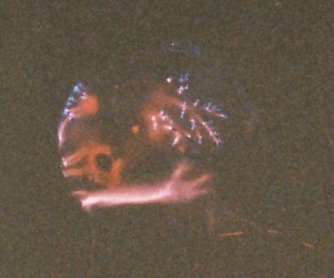

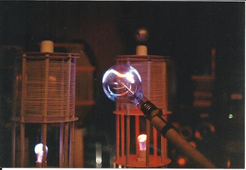

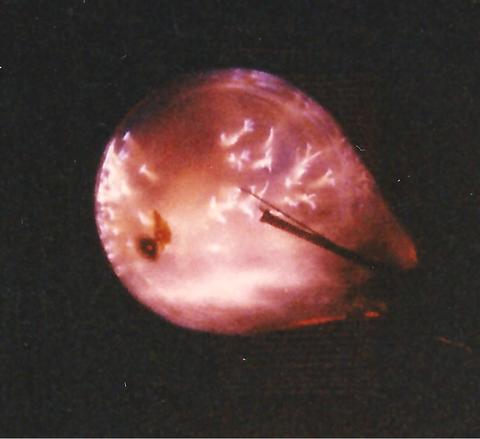

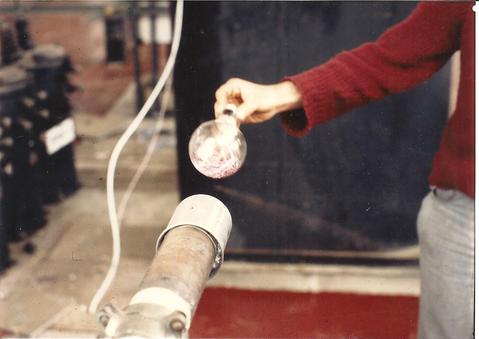

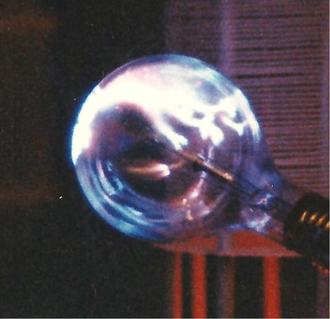

  • New EPD Cosmic Induction Generator Photos 2
    More.
    73 DE WX9HV

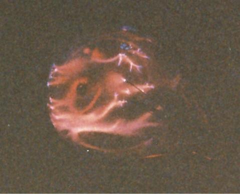

    • New EPD Cosmic Induction Generator Photos 3
      Yet more.
      73 DE WX9HV

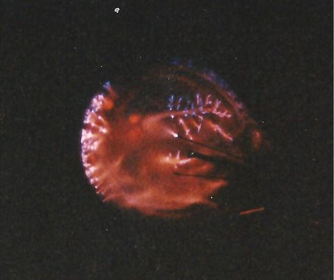

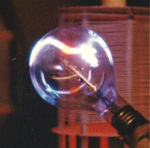

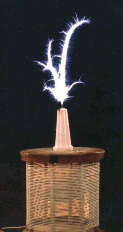

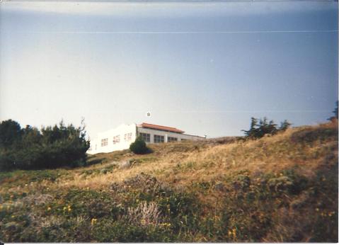

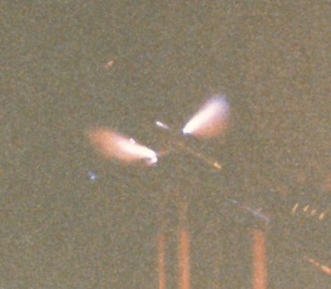

      • New EPD Cosmic Induction Generator Photos 4
        The last 4 are from the Marconi Lab prior to the Integratron.
        Also threw in another photo of a TMT single terminal discharge I haven't seen posted in awhile.
        73 DE WX9HV

                          • Originally posted by Lambda View Post
                            73 DE WX9HV
                            I wanted to comment on that pic of the TMT single design. I've worked for various agencies in the past that did defense (intentionally leaving out the acronym) work. One of the depts was working on a project that included a unit so similar to that it's downright spooky. coincidence possibly? but I never figured on seeing any of that stuff in the light of day to be honest.
