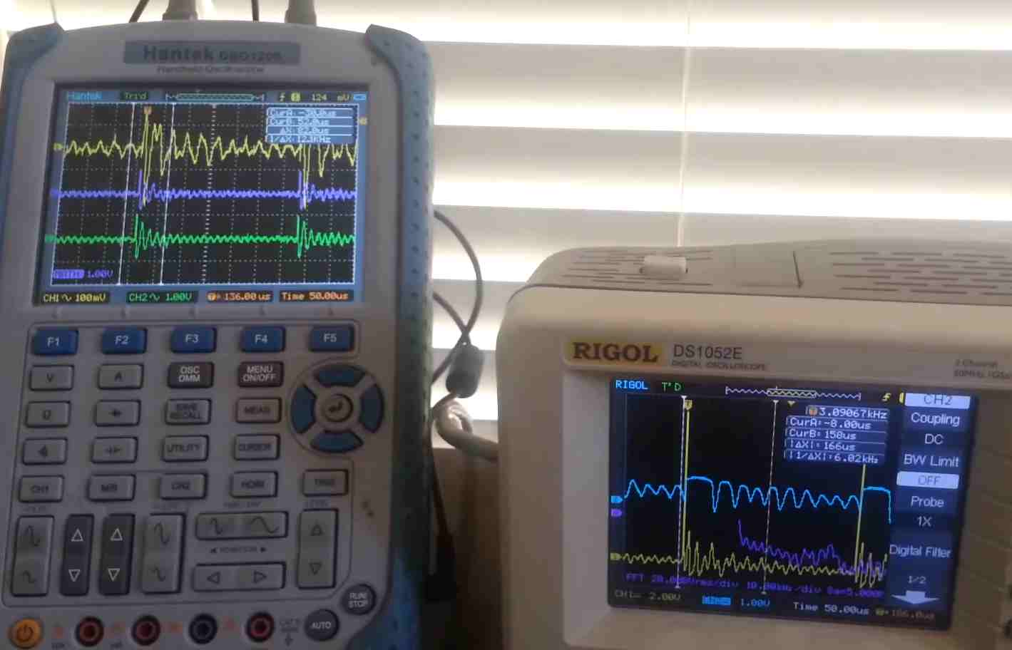

                    The signal down the line isn't very powerful, but I did notice these strange waves... they really seem to come from nowhere....
Name:	LMD Waves 1.jpg
                    • Click to edit
                      LMD Mystery Pulses Test 4 - YouTube
                      I thought maybe that the oscillation of the emitter possibly biased it to the gate which caused it to conduct, but that turned out not to be the case, and the bias between emitter and gate is 0 during the time of oscillation.
                      They also appear differently on different scopes (different probes?)
                      I updated the schematic to include equivalent circuits for the probes that are attached in-circuit (or nearly in circuit). But I don't think they explain the oscillation. I was also moving probes, and wondered what would happen if I rebiased the ground to real ground, and ended up shorting ground to the emitter, thereby bypassing the bridge rectifiers and the coil, but still I get an oscillation in the coil.
                      ... So I went looking for what sort of thing makes waves chirp... I remembered something from one of dollard's videos about the math that is per sec^2... which means the decay happens not just with time, but more and more as time goes. How do I compensate for that? What if I use a conical coil that's good for wide band signals?
