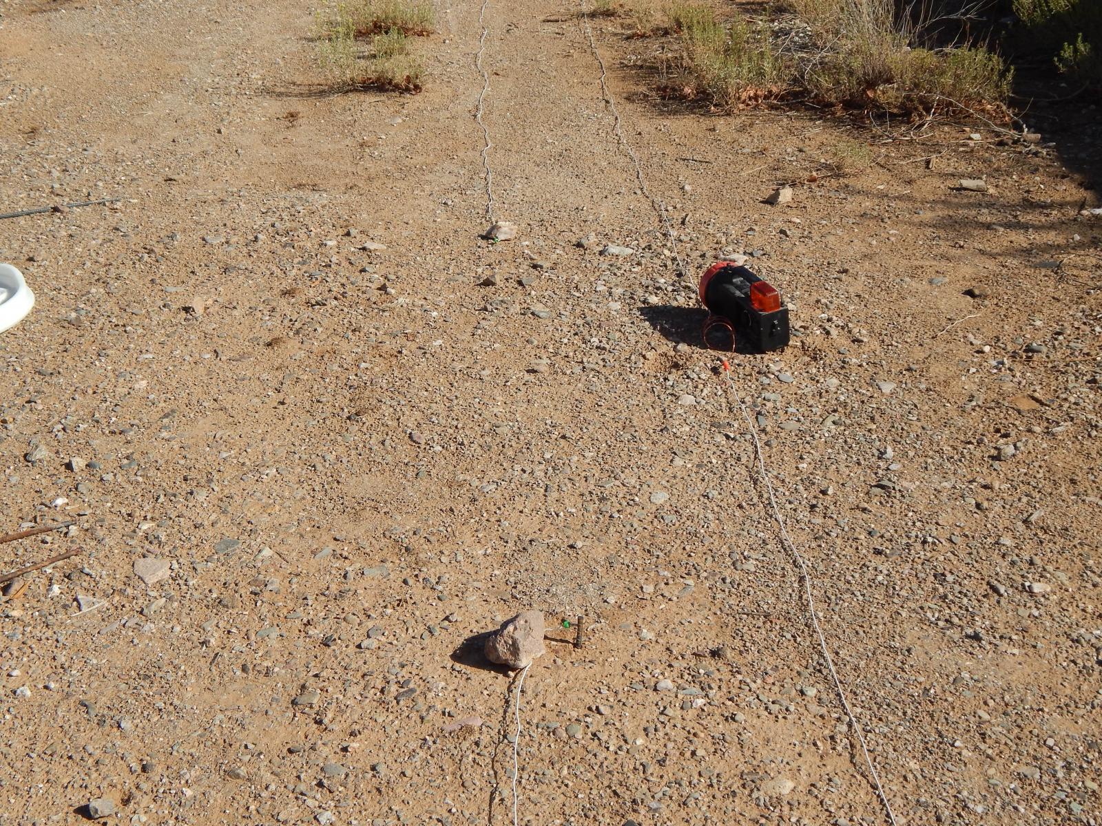

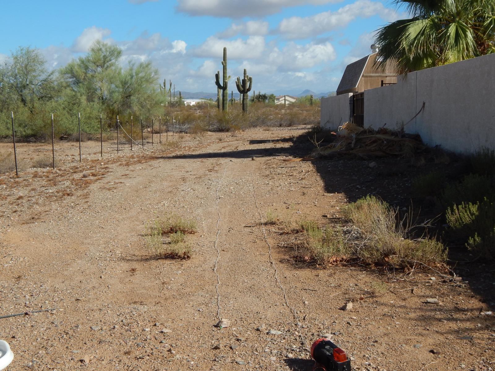

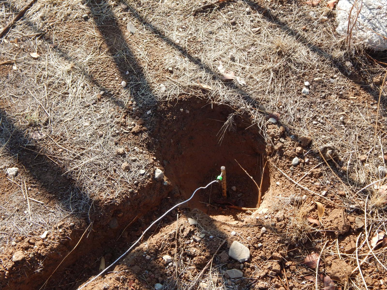

                            In the past week I did some experimentation by trying to duplicate Eric's telluric antenna system.
                            I laid down on the ground two 100 feet long insulated wire (1.2 mm dia.) in a straight line.
                            At the far ends of the wires I drove into the ground two 30 inch long grounding bars with quick connects.
                            In the middle of the two 100 feet wires I connected a 2 1/2 turn wire loop (2 mm dia.), loop dia. about 3 inches.
                            I have a not to sophisticated AM/FM radio.
                            First, the ends of the 100 feet wires were not connected to the grounding bars.
                            I took the radio and tuned it to a very weak AM station (rotating the radio until the audio was barely noticeable). Next I moved the radio next to the wire loop while keeping it's relative orientation the same. There were definite improvement in the audio strength.
                            Second, I connected the ends of the 100 feet wires to the grounding bars. The audio got noticeably louder.
                            Third, I removed one wire end from the grounding bar and the audio got even louder compared to the previous setting. It did not make any different at which wire end I made the disconnecti.
                            Conclusion so far is that having a long wire laying on the ground and split in the middle with a few turns coil added and one end connected to a grounding bar considerably improves the radio's AM reception, just as Eric demonstrated in his video. I will run one more test where I will run the two 100 feet wires parallel to each other 12, 24 and 36 inches apart to see if these make any difference in reception. This may demonstrate that "folding" the wires will accomplish the same as wires on a straight run.
                            Next step is to burry the wire. For this to happen I have to dig a 200 feet long trench in a very hard soil. The only way I can do this is to use my pick axe. I am shooting for at 6 inches depth but if my strength holds out I will go for 9 inches. The other problem is that the local temperature still hover around 100 degree F.
                            I thought I will be clever and name Eric's system a "grountenna", but before doing so I "googled" the word and to my surprise I found out that I was about 90 years to late. It appears that in 1925 a company "Western Coil and Electrical Co" was advertising a device called the "Radiodyne Grountenna"that was suppose to make the use of all outside "aerials" for radio reception obsolete.
                            This left me with the choice of the word "groundantenna" for which google showed no usage.
                            Your comments and suggestions are welcome.

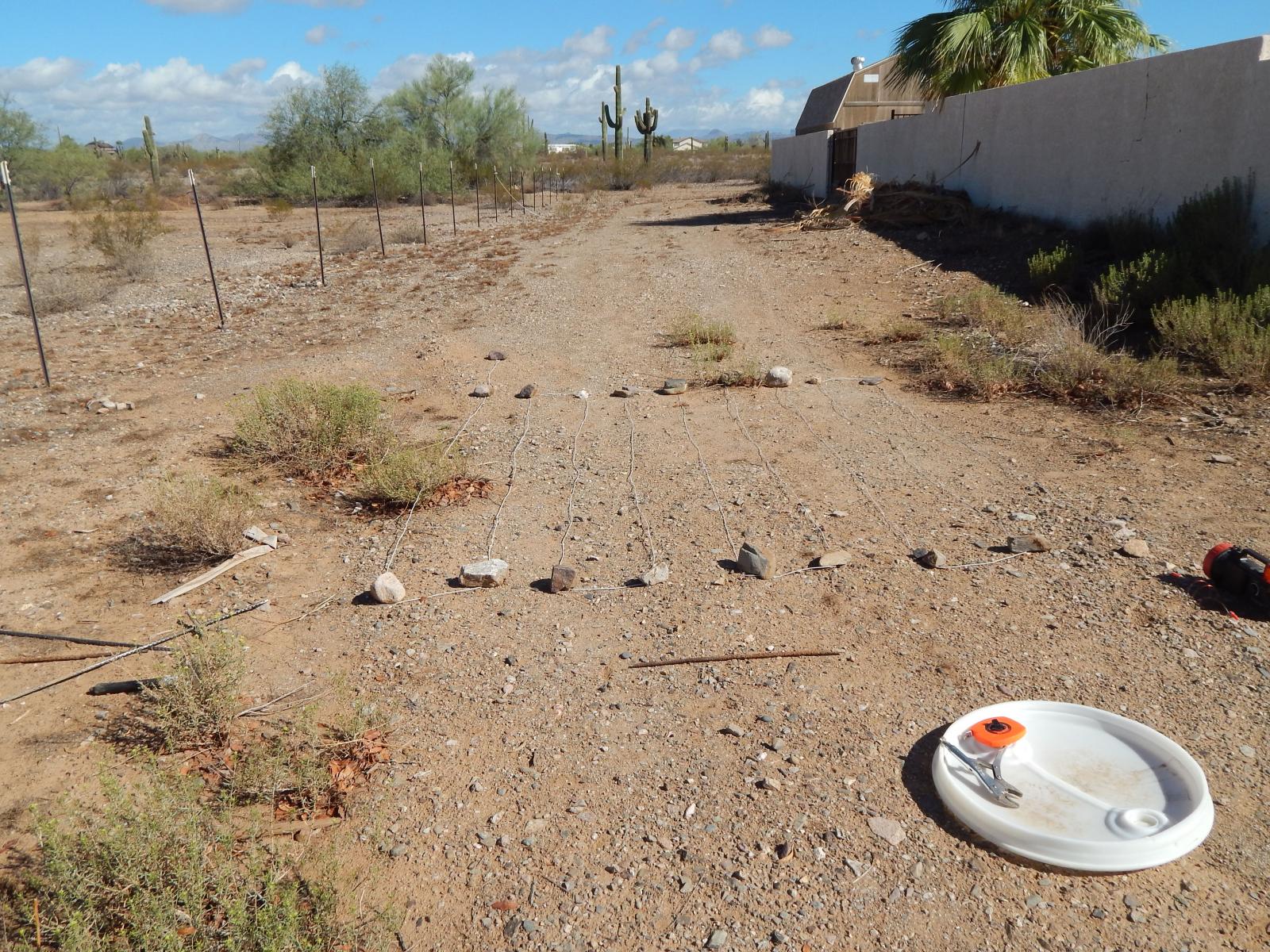

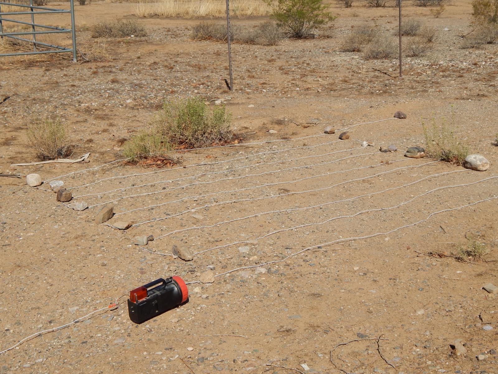

                              I did some more experimenting with the two 100 feet wire arrangement. First I ran each 100 feet segment by folding into two 50 feet length, parallel to each other, about 2 feet apart. The result was that the reception decreased by the amount the ground connection provided before. In other words I could disconnect the ground connection without any change in reception. Next I ran one of the 100 feet wire back and forth 10 feet lengths about 1 foot apart. Again I did not notice any different in reception but as before the ground had no contribution to the reception strength. Next I took one 100 feet wire and coiled it up to 22" diameter. The reception got much worst. Next I ran one of the 100 feet wires perpendicular to the other 100 feet and it seemed to work as the straight run does.
                              In conclusion the two equal length insulated wires laying on the ground in a straight run with one end connected to a grounding bar and in the middle they are connected to a small 2-3 turn coil of about 3" diameter work well similar to Eric's experiment. It also seems that the perpendicular wire orientation also works well.
                              Now the next step is to burry the wires and see the result. It seems to me that the increase in signal strength does come from the ground below the wires. I think the reason for the folded wires not performing as well as the straight run is the way the telluric waves intercept the wires. When folded the same wave front meets the wire multiple times and since the wire goes back and forth parallel to itself, the effect on each run cancels out the effect on the adjacent run. On the other hand, the straight wire runs meet a much larger telluric wave front thus the result is a strong increase in reception strength.
                              Comments and suggestions are welcome.
