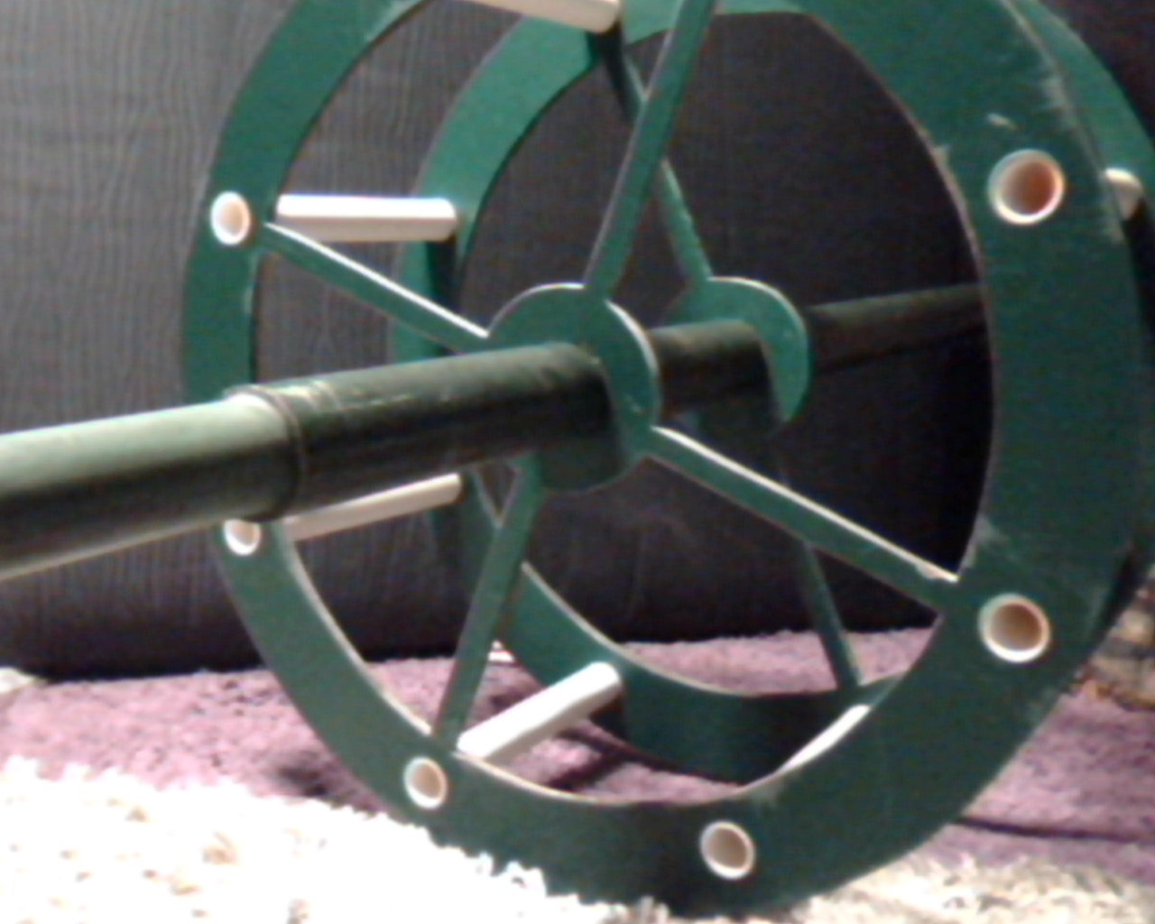

        Hello everyone , here a post of the first update on the 40 m HAM band TMT. all calculations by basic dr.e.d. calculations .
        I did put up a photo` s of the form made of TRESPA high-pressure laminate and 19mm white PVC rods . The center have a holder for a glasfiber pole to hold the coils in place like a steady antenna .
        disign frequency is about 7060 KHz
        i took a sec. coil of 6 turns , diameter is 358mm, wire diameter/coax braid 8mm and 5.5mm space 78mm highcoil wire l. 6,75m L=19uH and Sc=24pF
        Fr=7.45MHz with 5,8tap the ring cap can de about 4 pF Helical Coil Calculator
        I will make special ring caps they come on the pole .
        The extra coil is about 16.675 meter long wire , 143mm diameter ,8mm coax , 5,5 mm space , 50,5uH 8.7pF about 2 pf to tune to the ring cap . Fr=7.75MHz at 36.7 tap some room for ring cap.
        no space for `real` extra reflection cap on top for extra coil.
        I`ll try this out then i make a nother extra coil with less on the coil like 1/8 wave on coil and 1/8 wave delay and reflecting cap .
        I made calculations to for a AM broadcast receive TMT on 675KHz here in the netherlands it would take about 300 meter 8 mm coax .
        however i might pull 1000 watts or more of the transmitter site close by the site .
        i will post the radio maria AM MW TMT later on .
        show you some more within some days the coils and basic measurements.
        greetings de PD7Z

                      • 40 M telsa magnifier transmitter
                        Hello Every one , John here from the netherlands .
                        Today i will wind the sec coil on the construction.
                        Just removed the isolation layer shield so i have just the coax with braid .
                        Put a Little video up to show the basic what i want to do and how i will build this TMT . Tesla Magnifier 40M Ham - YouTube
                        on sunday i start with the prim. coil . the comming week i do measurements and make the special ring capacitor .
                        I will post some video` s this week about the tesla flat spiral antenna ` for the 11m CB band .Good luck to all
                        73 de PD7Z

                            • It's looking good so far AstroNod. I'm not convinced about your decision to use 6 secondary turns but it will be interesting to get some data on it anyway. I think that perhaps transmission through salt water won't be challenging enough, I think it will practically be as simple to make work as using a wire to connect the coils directly. Although I don't know what kind of range/volume of water you have in mind - if it's in a container and not an experiment on a beach there shouldn't be any difficulty whatsoever.
                              • Hello Dr. Green . Thx for the reply .
                                The formula` s of E. Dollard make it clear why it wil or won` t work into formula specs . basic.
                                Lo = c / (2*phi*f)
                                Here i show you when i try 20 turns .
                                Lo=6,75816meter Lturn=0.3379meter diameter coil is Lt/phi
                                W=10.76cm
                                coil height is 0.2 * W = 2.1 cm high
                                So 20 turns of wire with 62 % space with just 21mm high .... ok
                                lets find out .
                                ok with 0,75mm wire and 0.5 mm space i have 61.7uH and 7 pF
                                will make resonance of 7.66MHz
                                when i want to put ring cap on it of 2pF i am already at 6.75 MHz too low .
                                its very hard to make a 0.5mm spacing good .
                                i could use a 19 turn tap the i would have about 2 pF tune range. wire is now 6.4 m long .
                                OK extra coil .
                                Le=16.67meters ((phi*phi) / 4) *Ls
                                We=0.4*Ws that make 27mm diameter
                                Lturn extra is 84,51mm -->8,45cm
                                N = Le/Lt 1667,5cm/8,45cm +197 T
                                OK
                                lets put in the #`s in the calculator
                                1 mm wire and 0.6mm space
                                L =85uH C =4pF Fr=8.63 MHz 2pF tune range
                                with 195 turns there is 3pF tune range .
                                Well you see Dr . green it can be done but very hard to make it with 0.6mm space and 0.5mm space i might try it one day but not tom.
                                Sure this system have more Inductance than the 6 turn /37 tun i make now however that thinner wire have more resistance to .
                                Ham radio operators use 10 a 100 watts barefoot and legal lim. in there country .
                                However nice small model .
                                There 2 thing is do other is less sec turns and more prim turns.
                                And remenber electricity is dielectric and magnetic so with the 20 turns it have less dielectric 3.5 times less . and 3 times more inductance . Less current and more voltage with th 20 turn model .
                                So Dr Green i just want to show that it is hard to stay in the ref. specs.
                                62% space and diameter to hight ratio for both coils.
                                And the prim coil for 107.5mm 2 turn give 0.9uH
                                Flat Spiral Coil Calculator
                                2 turn 107.5 mm 5 mm space 0.9uH needs a 560pF cap. to tune it at 7.060MHz
                                However less inductance give less E in the prim coil to send to the sec coil .
                                with a 358mm prim. 3 turns 5 mm space there is 7,4uH about 8 times more inductance ,Naturaly the voltage get doubled at resonace LC at both options of prim coils.
                                If i would use one turn prim. 358mm i get 0.85uH needs about 600pF to tune. Silver mica and a small air cap to fine tune it is a option .
                                with the 3 turns it can have just a aircap var. or better vacuum cap. var. Vacuum caps could make good `ring` caps when your voltages are getting in to the tesla range... those must be Huge to hande 100kV` s or more . To think of the plasma Part Tesla wanted to make for wardenclyffe .With modulation that would be like a Plasma Speaker .
                                With the 6 Turns it have the same F resonance and good Z tune for the Ground System .
                                Well Sea water is a good conductor best of all Grounding types .
                                The range what is usefull will be about 175 miles or till 250 Km to me thats local.
                                Well any rage is ok for testing will be nice if HAM`s could transmit trough the earth when the BAND is closed normaly speaking .
                                I am looking for Telluric Range DX. My normal QUAD antenna is use for HAM radio have great range when conditions are good .
                                to test it i make 2 of those antenna ` s with that i go testing in the fields and make video` s .
                                Practical applications that the goal.
                                Lately i got interested at ELF SLF LF VHF spectrum there telluric current go almost everywhere like eric mentioned a world wide ham net on 500KHz (476KHz)
                                I will pick up a defective submarine antenna this week the amp is gone sea water but the coil/antenna is 100% . Its very heavy ...
                                Its this one http://www.sippican.com/stuff/conten...nna_system.pdf
                                All the best .
                                John de PD7Z
