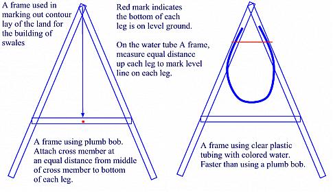

    Laying out contour is easy with an A-Frame ..
    Usage:
    1) place aframe down .. move one leg around until you find both legs are on
    equal evaluation ground, the legs are level.
    2) place a stake at one leg
    3) like a compass you draw circles with, swivel one leg around until you
    find a level spot. Stake that leg, repeat.
