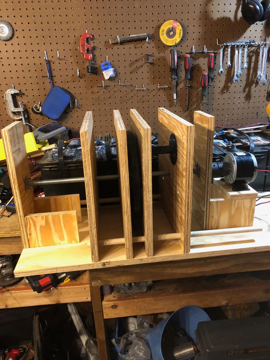

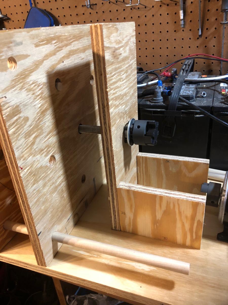

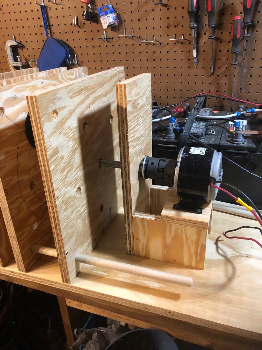

    Yesterday was able to get a little more work done on the upright generator. working with wood is real pain, but trying to get a decent alignment is possible just takes more time. I would recommend using the hard plastic Dave Turion uses in his video. That will be my next build hopefully.
    Of the (4) vertical 14" x 14" pieces only the outside two move out to insert coils as they are needed to be rewound for testing and such. PVC pipe will be cut and placed in between each vertical board on the dowels as spacers to hold each one the correct distance apart. All parts are non-metallic to avoid interference with the rotor magnets. Even brass or aluminum screws can get eddy currents in them. (From what I read)
    Well I did spin it up with the modified Matt motor there and it had no vibrations to worry about. Cause the threaded rod I wasn't sure would balance good or not. When the rpm increases it may do an Irish jig across the bench? No, I'm not Irish. Therefore I'm hoping to get the coils correct winding and core material to avoid heating and keep the rpm low. This my coffee drinking friends will be the greatest challenge of ALL. But one hill at a time.
    Hope these pics help. All teaching and positive comments are welcome,
    wantomake

    Here is the progress made today with what little time I had. But the milling down of the threaded shaft took some time for the bearings and the coupling. Takes time to not over do it and nothing fits.
    There will be end plates holding the bearings and the coupling will be connected to a modified Matt motor as show. All is just put together to show me how it will all fit together; spacing to install or remove coils, motor block spacing and such.
    Hope to get more done as days of dry and warmth help out. I'm sure there's more to this build as yet to present itself. But will keep posting as much as gets done.
    wantomake
