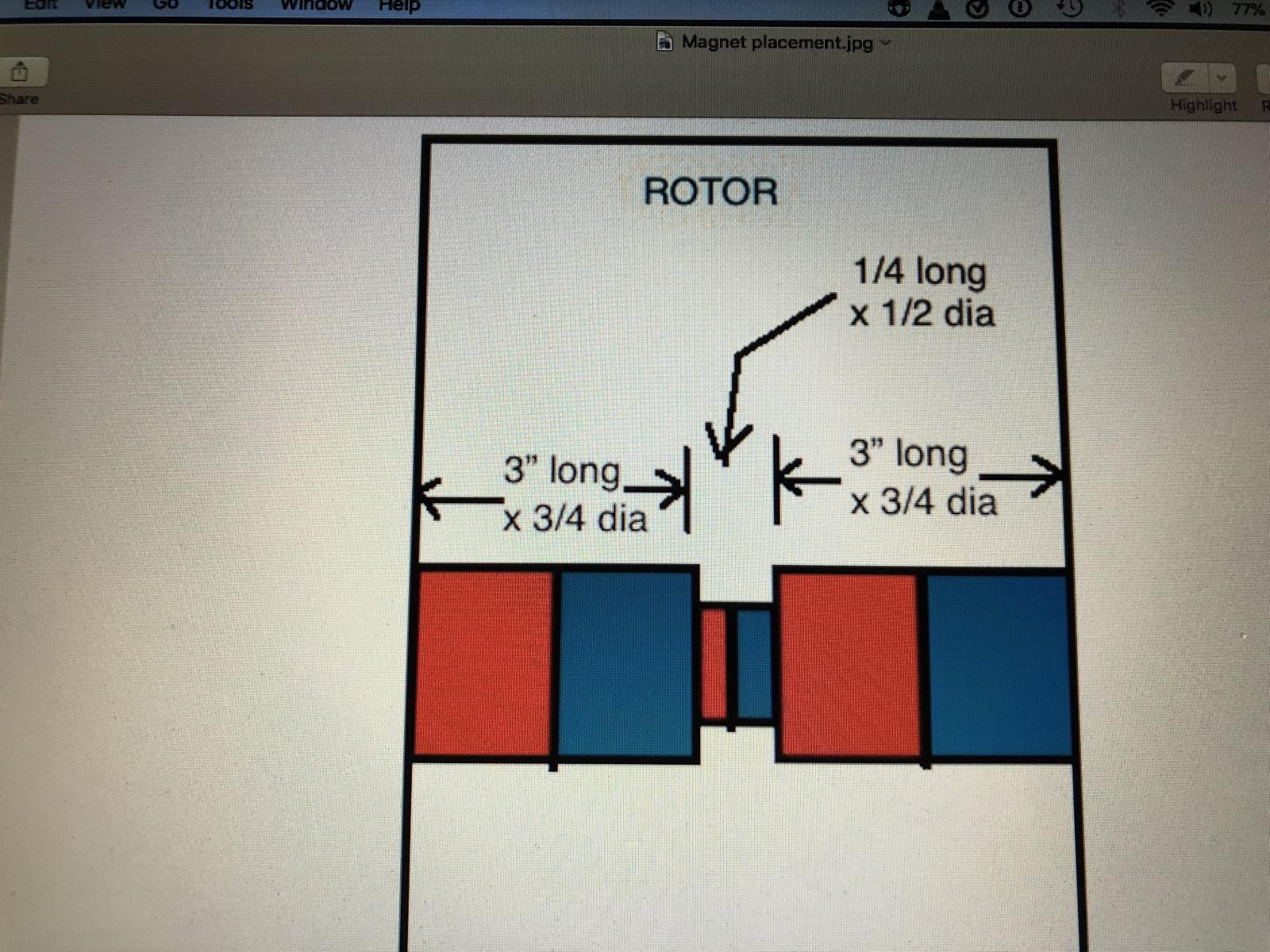

Attached is a way to make SURE the magnets do NOT come out of the rotor. In the 41/4” thick material you drill in two inches deep and 3/4 wide from each side. This leaves you 1/4 thick material in the center 3/4 diameter. You drill a 1/2” diameter hole in that material and fill it with a 1/4 thick by 1/2 diameter magnet. This acts as a magnetic link between the two larger magnets. Good luck getting them out!

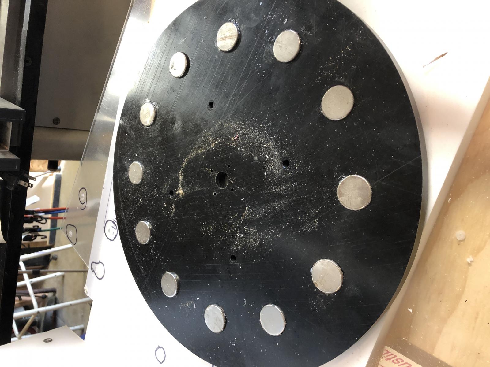

Also attached is a picture of arotor with magnet centers at rotor centers. This is what needs to happen to fit the construction of the coil holder from the size materials I have shown. As you can see, there is plenty of room between magnets. There needs to be at least a magnet width between magnets , and I have more than that. But I also have only 12 (on each side) magnets on the rotor. I have room for more, so I am going to look at that.
Have you built a rotor WITH iron shielding and one WITHOUT iron shielding around the rotor magnets to measure the difference in coil output? I ask because adding iron shielding basically increased the diameter of the rotor magnet which means you can have FEWER magnets on the rotor. If there IS a gain from using magnetic shielding it is going to be x amount per magnet pass times a number of magnets vs a smaller output times a larger number of magnets. Which gives the most output? I don’t know. I really can’t afford to build two rotors to compare the difference.
Also, it doesn’t have to be 24 magnets or 12 magnets. It can be any even numbered amount.Last edited by Turion; 06-24-2019, 02:59 PM.
