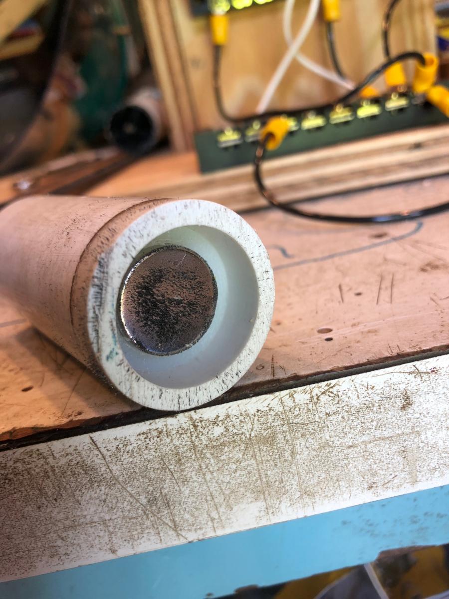

To All,
A good rainy Saturday morning with hot coffee in hand as thunder rolls across the land.

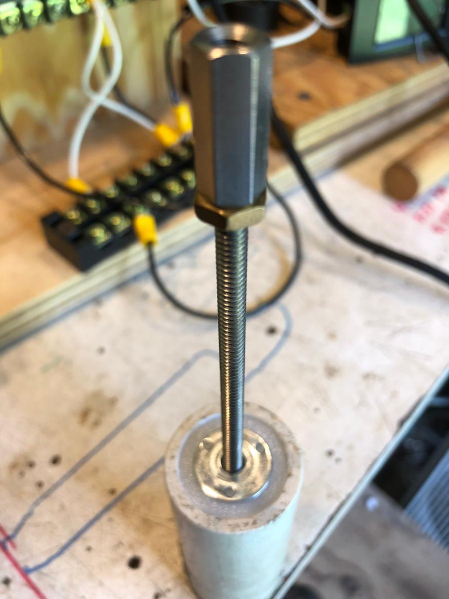

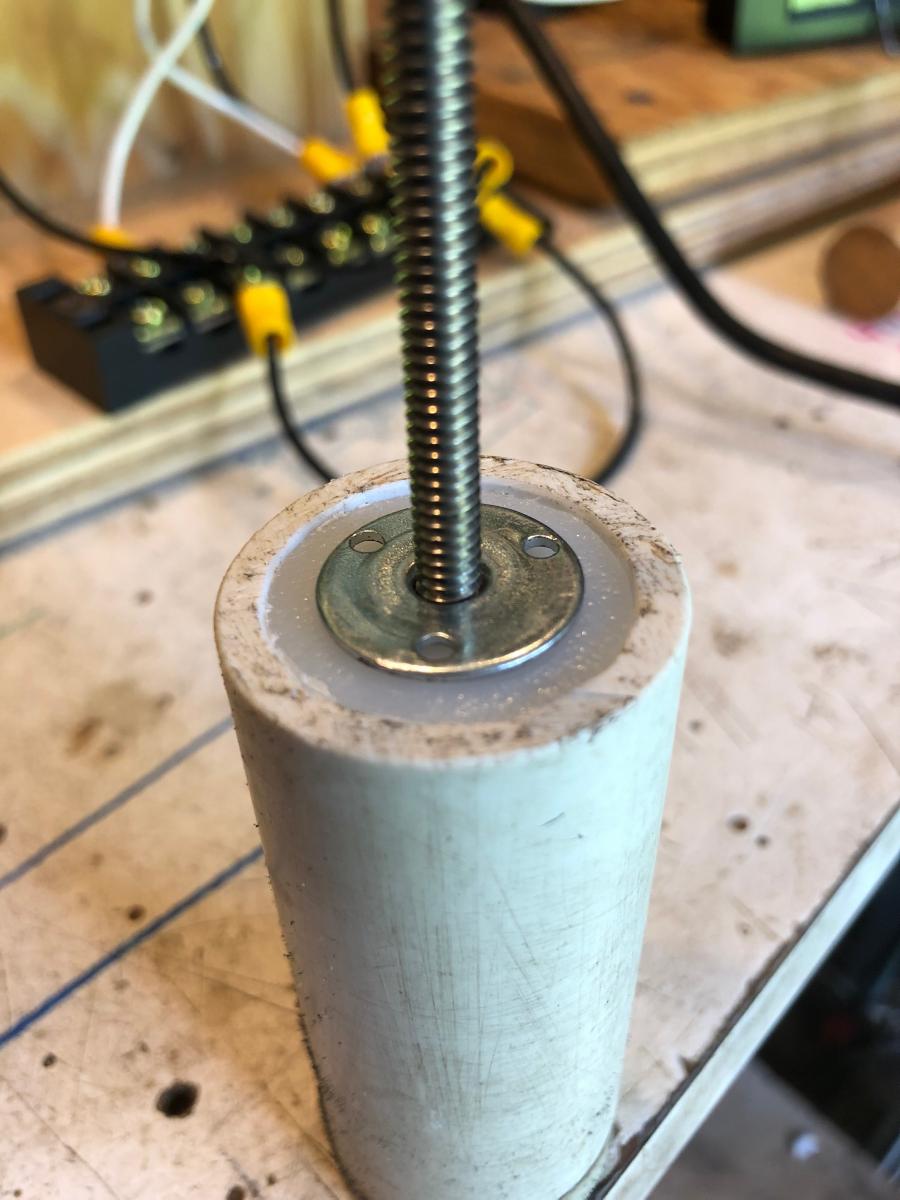

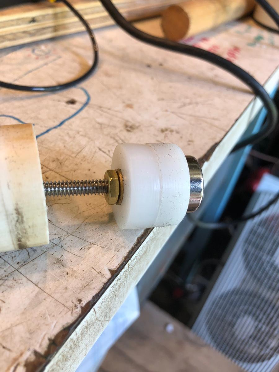

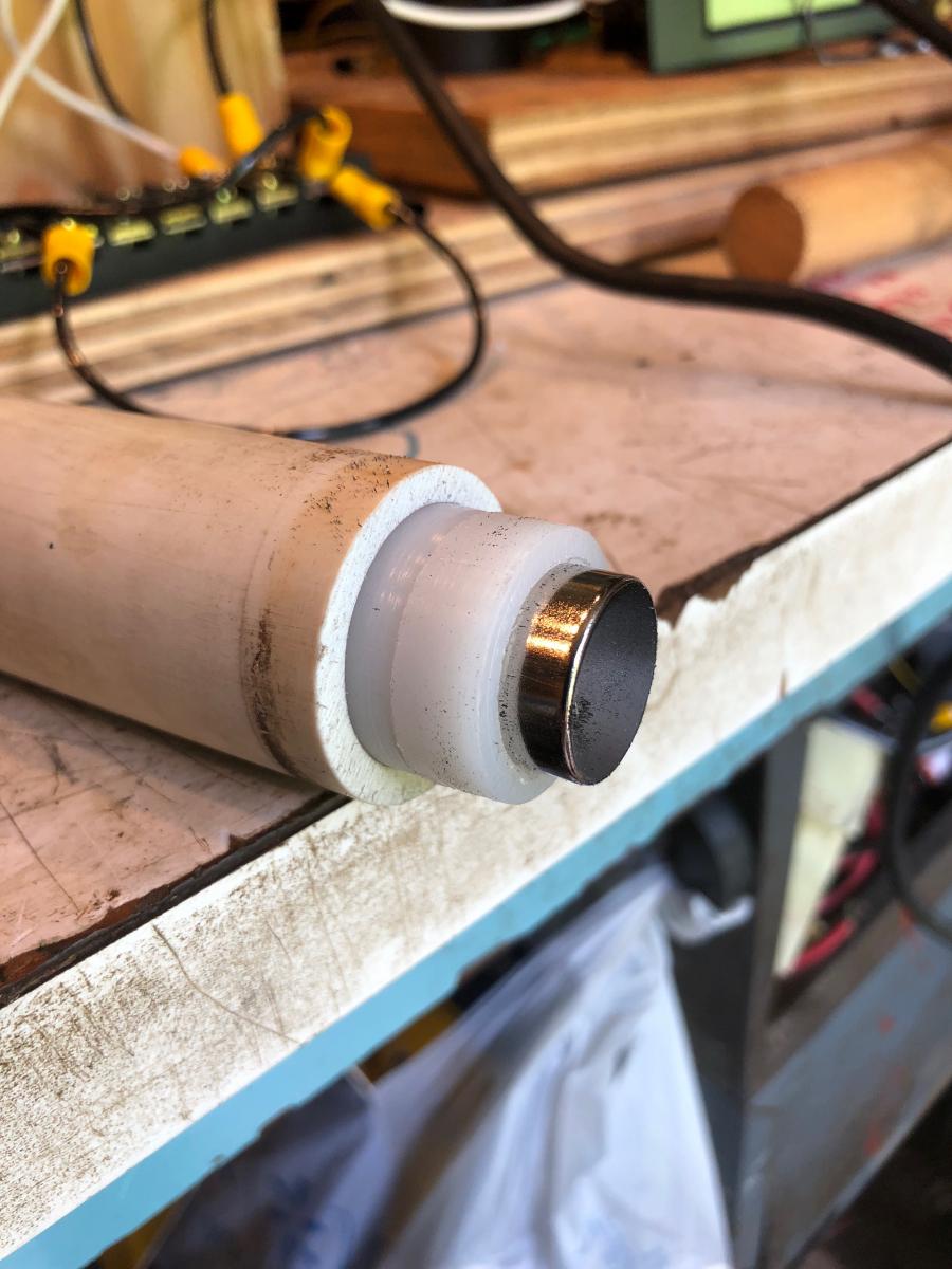

Was able to get some shop time yesterday finally!!!! I'm working on the opposing magnet holders with adjustability. PVC 1" pipe with hand crude made holders for the 3/4" x 1/2" neo magnet. Will expoxy them together later today after a good buffet breakfast with my best friend(wife) and letting her shop for several hours while I do shop time.
Will hit Lowe's for a few items while in town. Planning to use pvc 1" caps to hold that adjustment threaded rod in place. 1/4" diameter I believe. Dave showed them on the video. Also making holders to prevent wobbling of the rotor.
Word of caution to anyone using plywood to build this machine. My end pieces that holds the axle bearings has bowed and unusable. Even with 3/4" plywood. So I'm shopping for some 3/8" to 1/2" aluminum plating to use. Lowe's does carry some steel plating 3" wide that I may use but will see.
As progress shows my financial supporter success, then the wood will be replaced with polycarbonate stators and base.
