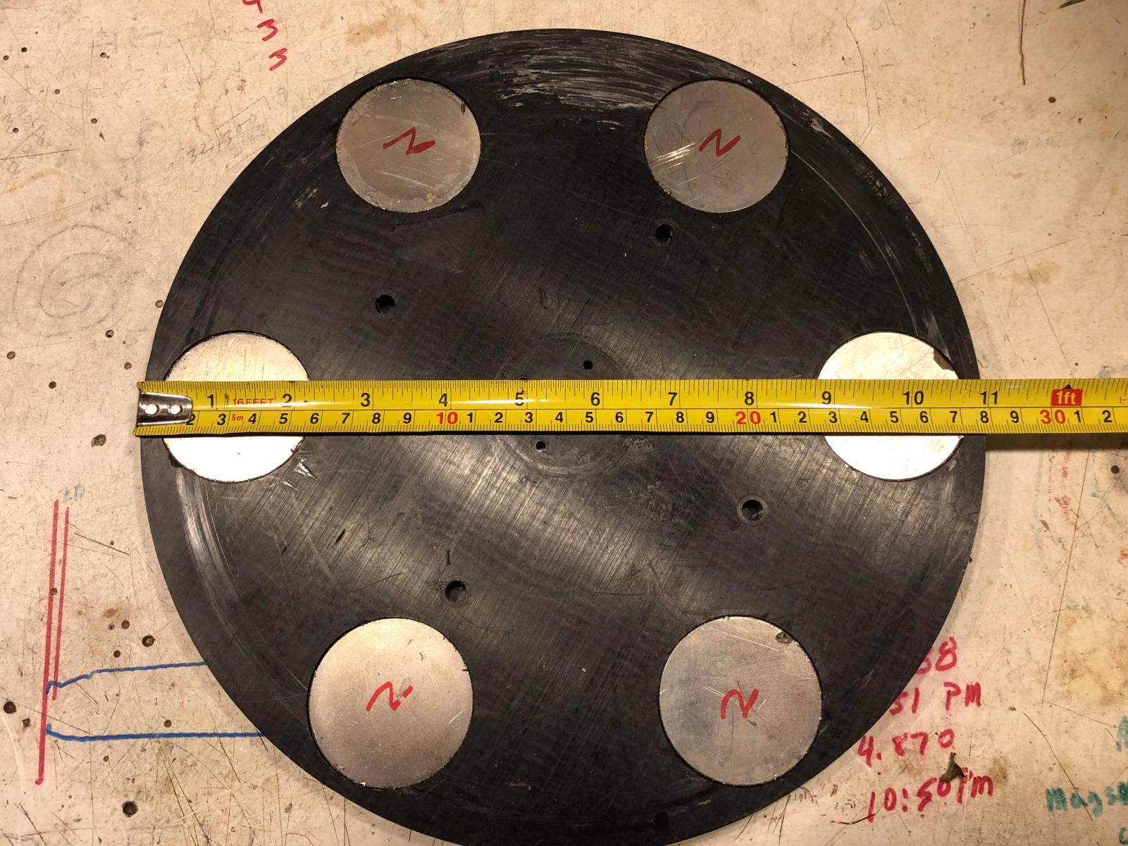

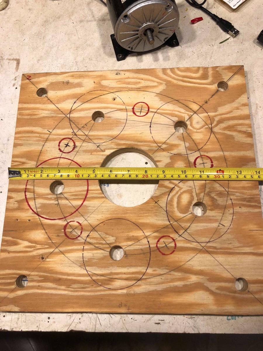

Today and tomorrow will be good cool weather and chance for me to get some generator building time.
I'm using 3/4" plywood as stators holding the coils in place. The plan is 5 coils on north side of the rotor (with 6 x 2" x 1/4" mags) plus 5 coils on south side. Total of ten coils. I think the plywood 2'x4'x3/4"was $16.88 each. I got 3 of them.
The larger circles will be cut out to make it easier to install/remove coils. The smaller red circles is for something else. I will replace the wooden dowels I used with aluminum rods or bolts with the pvc spacers.
Still need to order another spool of magnetic wire for next coil.
More to come as money and life allows.
