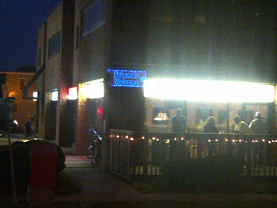

                    This being the most recent thread on JT circuits, I'm trying to see if I can use some parts of some burnt out EL wire drivers (real cheap crap from China) that run from 2 AA bateries. The wire is fine but the buggers keep blowing so I would like to try changing what I need to light the EL wire.
                    There is a black gob covering a control IC but I've reverse enginered from the EL wire back to the trace coming from the contol IC.
                    My questions are: are these juole thief circuits talked about on this site just stipped down Hartley ocsillators? Is all I need to do is connect R1 to + to get it to start?
                    The transformer windings resistances are:
                    pin1 to pin2 = 195 ohms
                    pin2 to pin3 = .7 ohm
                    pin3 to pin4 = .2 ohm.
                    This is for an outdoor solar powerd sign with 4 banks of 3 x 1.2 volt nicads that come on at dusk (you can't see the EL wire light during the day).
                    Here's a pic of when it was all working = 5 EL wires around the letters.
                    Any sugestions/help is very much welcomed.
