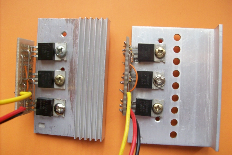

        torpex,
        if you are running MOSFETs paralell, you need good driving current. Connect output from generator to TC4422 chip - http://www.farnell.com/datasheets/79492.pdf
        Connect one side of 33ohm resistor to MOSFET gate and second side to driver TC4422 pins 6,7. Do it for all of them. One TCxxx driving paralell MOSFETs. This solution gives you very steep pulse and enough energy for driving
        See datasheet of TC4422 and DO NOT exceed power supply and let me know how is going.
        regards,
        Cinan

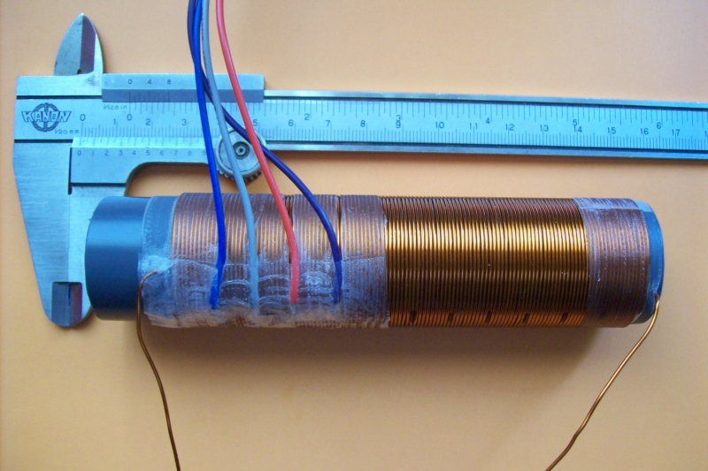

                              Hello Cinan,
                              Ok, here are the spec's of the latest Coil on my last video, that outputs power to five 120V/23 Watts CFL's, to my believe it is a good Coil for you to start winding...
                              Outer Diameter of Core =2.0 Inches
                              Height of coil= 2.0 Inches
                              200 Turns 18 awg wire (double strands), connected in parallel start with start, end with end.
                              After finishing winding the outer wire diameter gets very close to three inches.
                              The way I wound it:
