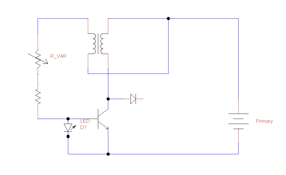

    It prompted my own cap bank foray though, and, perhaps some weird results. That first battery has definitely held at 4.25V now, the second battery is being trialled.
    Here's the circuit i'm using:
    Mistake on the diagram - D1 is the LED, D2 is a germanium 1N94 type.
    Maybe the D3 is needed, maybe not.
    It'll run on the caps alone for a minute without the D3, but will charge the caps very slowly and possibly pass energy to the battery with it in place.
    If nothing else, many people will have homebuilt SSG's and can connect things up to try the idea out
    Slider,
    the only way I get this to fire is if I reverse the trigger coil leads. are you sure the top of the coil goes to the emitter and the bottom to the base?
    I'm using everything similar to yours except battery and transistor, been swapping out different transistors to see if I can get the effect to show up.
    my coil keeps warm - no where for the energy from the power coil to go.
    Patrick
    • #17
      Ah, no...the windings are regular. I stuffed up on the schematic drawing conventions.
      The power wire outer goes to the positive rail.
      The power wire inner goes to transistor Collector.
      The trigger wire outer goes to 100ohm resistor.
      The trigger wire inner goes to the negative rail.
      I'm a lot newer to these circuits or indeed schematics of them than you are and respect that you've tried the circuit
      Do note though, that I used a germanium as D2. That's because of the 0.245V drop across it and relates to recent crystal radio work. Is it in fact 'better' than a 1N4148 or other diode ? no idea.
      The circuit will run with no caps, just the regular battery power.
      When 'correct', the D3 can be omitted and the caps directly connected to the positive rail, with no battery. Like that, the LED will fire and the circuit run for a few seconds, the rotor will slow and the LED gain brightness as it does so. Without caps or battery, the circuit won't fire (DadHav once showed a Bedini circuit generating power, when he spun up the rotor with a Dremmel type tool).
      The bi-filar is of the same gauge for both windings, 26 gauge, actual R-Charge wire straight off one of their spools.
      The windings were checked for continuity.
      The LED replaces the normal 1N4007, the Collector only fires the power winding and doesn't share output through a diode to charge a secondary battery, as normally done.
      Instead, the charging comes from the Emitter and LED throughput.
      If you get the LED to flash and visually show the firing, then that's what you want to see. The LED method is a furtherment of I think it was Neight's method...where he mentioned to put one across the trigger winding to show a circuit is firing. In my method, the LED also suits the run voltage and becomes an indicator of charging power. The LED brightness is dependent upon the amount of transistor Base leg feed from the trigger coil.

          OK, we have the coil part straightened out.
          what about the caps... you have c2-5 in series and then all 4 in parallel with c1.
          however...
          their polarities are reversed?
          so c2's neg is connected to c1's +
          and c5's + is connected to c1's neg is that on purpose? this makes my caps work backward.
          I can get d1 to light only if I reverse the direction of your drawing.
          does this mean the other 2 diodes are also reversed?
          I have it working better now, the coil does not warm as much so I'm only asking to make sure I replicate it correctly. I do have the germanium diodes left over from the original joule ringer days :-) I know I'm pretty close, the caps charge to 10+volts.

            Slider,
            maybe... could you take this picture - I removed the charge battery can you add your diodes and caps?
            I read your discription above and I do not have enough common sense to piece it together
            Patrick

              Will do and repost later tonight...it may be very late though LOL
              Probably the same as many folks, I build, solder, resolder, swap a component or two. Then, cludge along to follow the now messy soldering to create a schematic. What i've done before now is to forget simple things like LED polarity swaps ! I think i've posted about 3 schematics ever.
              So, it's very much a good idea to redraw, follow the actual first build again and at the same time aid your replication.
              *edit* wait a sec, you have the trigger coil connected to the positive rail, instead of negative rail ?
              The caps are one large one to run from and several tied end to end in series. By PMMG4HYBRID's explanation, the smaller ones should shuttle power around and fill quite quickly, the larger one soaks quicker than the battery. The final result is a battery which is doggedly slow to respond compared to the caps...allowing it to charge when it can.
              In my first circuit, there is another 5.5V 1F cap...which i'm debating whether to remove. However....I believe the rule is to leave a first circuit completely alone and replicate with another, that includes the changes.
              My original idea, was to time charging 'naturally', using the lighting of the LED as an allower of power back through to the battery - making charging out of phase with the power draw. Far easier to employ than complicated circuitry.
              If you hook up a battery to the circuit you'll see zero draw until the circuit runs. That same zero draw condition exists, I believe up to now, between moments of an SSG firing. It's the relaxation time and charging opportunity time. So, perhaps a delay line would work even better.
              Anyway, just thoughts.
              If your LED lights correctly and you're charging the bank to 10V, then give her a whirl and see what happens
              Nothings set in stone here and if any modifications you make to the circuit work out better, then 'jolly good show' !
              The White Lion name in the video description is just something of an identifier name, to theme with the White Crow of last year. It's a play on Li-Ion. I know you don't go for naming things by peoples names, so perhaps as a project name the White Lion would work.
              That is, indeed, if there is a project to made from these rewired SSG cap dumping/charging/running experiments
              The coil should run cold, the transistor too.
              A note about transistor power requirements and heating - i've just got a 2N2222A version running.
              The coil is an 850 wind again, similar dimensions to the other. Nothing gets warm. The rotor is the same one off the other circuit, running at a comparable speed
                that pic is from a solid state SSG schematic, I forgot to move the connection back to the neg rail. :-)
                I should note, there is no heating or current draw until I spin it up, at these low voltages the transistor does not heat up, but the coil does. I know I have those caps and diodes hooked up wrong some how.
                thanks for any help,
                Patrick

                  I'd draw the schematic on paper anyway, because I don't have a printer with good cartridges.
                  Well, I hope this will help for now -
                  D1 - LED - Positive to Negative rail, Negative to Base of transistor (idea came from Slayer exciter).
                  D2 - 1N94 Germanium - Positive to Base of transistor, Negative (black line) to C1 Positive.
                  D3 - 1N4148 - Positive to C1 Positive, Negative (black line) to Positive supply rail.
                  Interesting about the solid state SSG. When I first tried to make one some while ago, I couldn't see how the transistor was to obtain a positive voltage. So I connected how you drew up the circuit above.
                  The coil made a high pitched squeal, which could be altered in frequency with the 1K pot.
                  It would burn holes in the variable pot (with smoke and that less than thrilling sight of a bright orange glow inside the pot housing - the only pot smoking that's been done in our house lol) and the coil would warm up pretty quickly too...but...would still charge a battery !
                  Needless to say, the wheel didn't move anywhere though.
                  • #24
                    Here ya go
                    Included is the var pot mod that was drawn on your diagram, as per an SSG.
                    C1 has its positive at the bottom, negative at the top to join the negative rail.
                    The other caps are in series, beginning with positive connected to C1 positive. Then - to +- to +- to +- and out to the negative rail.
                    Looking at it redrawn like this, improvements could be made. Like, running to the caps from across the LED.
