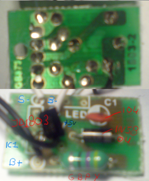

I "built" or better , reconnected, my donor (a solar one led garden garbage toy)this little with an extra battery, and started to do some basic testing.

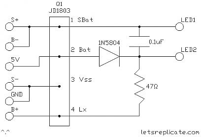

I think the circuit in there is already some kind of joule thief. Although It does not have a toroid. The Fan is an old PSU fan, rated at 12V 0,26A The four tiny blue LED's in the corners are hardwired with the fan. It spins nicely around (not full speed)
Now my first question is:
Do I understand it correctly that this thing: the fan and 4 tiny led's run on only 0,007A x 3,92V = 0,02744W
Does this run on 0,02744 watt ? That seems a little low.. do I measure incorrect?
Second:
Unconnected i get around 9V connected it drops to 3.9V is that normal? Can I see Voltage as "Pressure" what will get less when it is set free?
Cheers.
