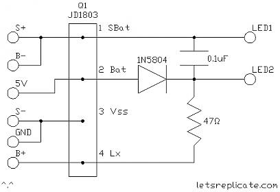

              JD1803 product description
              QX5252 datasheet. -> Translated by By Google (the pictures of the internal workings are sill not translated, which is the main information I'd need )
              I drew up the circuit from the IC, as best as I can see it. The connection wires are all on the left side with the LED output on the right:

                  I think I understand the circuit, TNX

                    1. A photo diode is pretty much the same as an LED, the casing lets light pass through it. If you take 2 of the same kind of LED, light one up and shine it into the other, voltage will be produced across the unlit one (not much current though). A photo diode is designed to only receive an not produce light.
                    A lumen is a unit of light like "candle power", it is the proper units to describe the brightness of a light source. LEDs take electrical energy in and emit lumens of light, and photo diodes convert lumens of light into electrical energy.
                    2. Possibly, depending on how it's connected you'll either be able to replace it with a switch, or a switch connected to a "pull up"/"pull down" resistor.
                    3. Probably not. I think the frequency is being controlled by the solar panel.

                          If it was not being exposed to any light at all, then it was not a photo diode. Which wires was it connected to on the board? Do you mean the 1N5804 that is on the board? That is just a high speed silicon diode.
                          • #14
                            Been doing a lot with these circuits myself. I must say, as a stock unit you're getting even better results than the USA K-Mart ones i've been dinking around with.
                            The inductor on your board (resistor looking jobby) is a 470uH. It's your coil, the toroid replacement in some ways that you expected to see on this Joule Thief type circuit. Now, in time and you may wish to do this, you can change that out for others. Or, as i have done, change it for an old AM radio loopstick. The current draw goes even lower ! Loopsticks normally have a ferrite piece in the middle and that is often rated at around 680uH...in other words, more induction.
                            I found that if you put a 1K variable pot and a small capacitor over the contacts to that (parallel) and fit those in series with the inductor, then you can change the current draw/alter the output strength.
                            Finally, if you connect a 1.5V rechargeable battery after the Positive output to the LED's in series with the LED's, then you can recharge it while running the circuit, for seemingly no penalty
