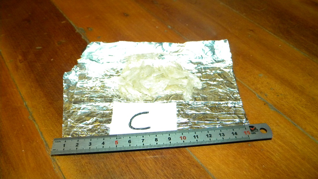

                            Seed Material for the C-batts
                            Hey,
                            Just wanted to add a few pics of the seed materials that will be utilized
                            in non-spec C-batts to test the properties.
                            Zero
