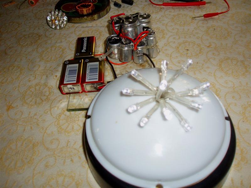

                        Hi folks, hey nick, well the results so far are looking fairly good, not 70 leds mind you, though lol, i don't have 70 leds to even try.
                        I used that small ferrite e-core and wound 10 bifilar turns, then wrapped over that, 20 turns, all 24 awg.
                        Used a 2n3906 pnp and a capacitor 104k in parallel with base resistor of 500 ohms. I had to use 2 AA's to get the leds to what I would consider full brightness, too blinding to look at for more than a split second.
                        So at around 2.5 volts and 41 milliamps input, around 103 milliwatts.
                        Not a bad start for 5 milliamps per led since I'm running 8 in parallel connected to the 20 turn secondary.
                        I'm using the 5mm white/bluish leds.
                        I'm using joule thief circuit with the capacitor added and the secondary.
