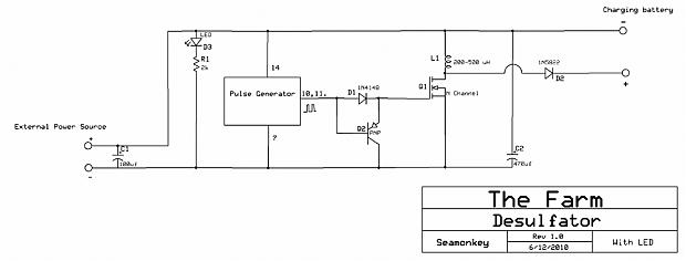

The signal generator is a standard dual-555 pulsewidth modulator with the
transistor hookup identical to how it is shown in the Desulfator schematic
attached below.
attached below.
