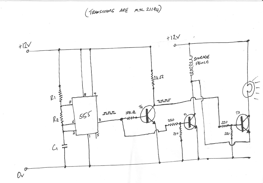

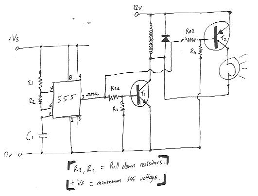

I love how you phrased that question. A polite way of asking if I had made some mistakes.
I will slow the pulse rate right down and connect up some lights to test if the signal inversion worked.
