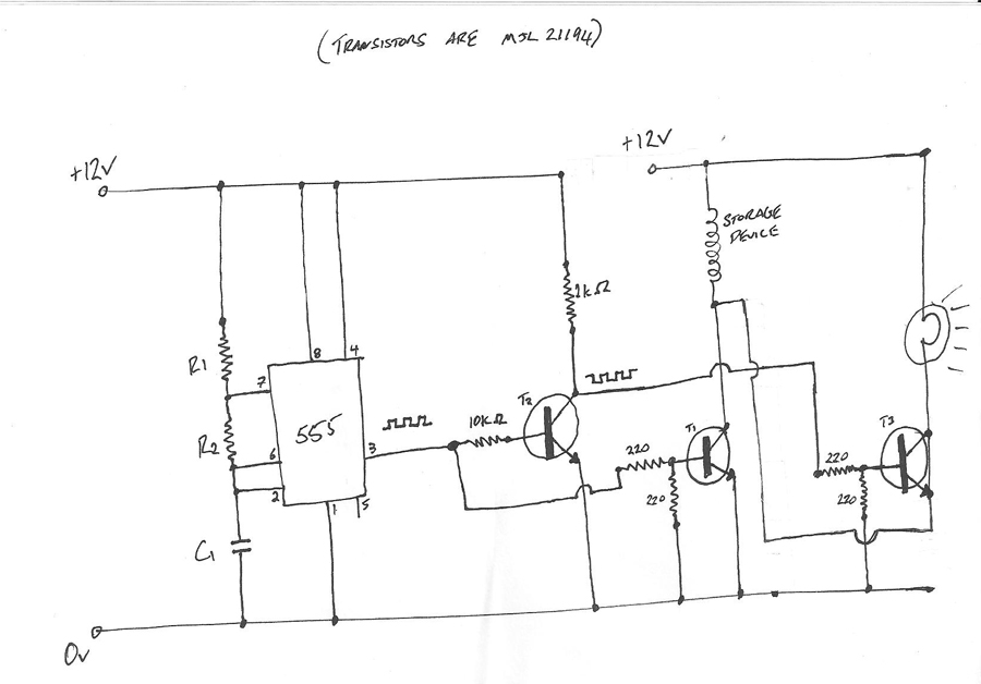

          StweenyA, what is the timing circuit you have for this project. I have attached a schematic of one I was thinking of using. I have tested it but I don't have two scope leads so I will have to slow it down to check the inversion of the signal.
          I am thinking at this stage I will just wind a coil using nichrome wire as it is easy to get.

              @dambit, where did you get that circuit from, or did you create it?
              I have never seen something like that before, it looks quite interesting. Does it completely disconnect the secondary from the primary? And does the basic concept even work?
              It looks like a few things are intentionally connected the wrong way.
              My circuit is quite simple, please view the link.
              The Bearden Free Energy Collector
              I used four SSR's in place of the switches. Problem with them though is they can only switch in ~100uS to 1ms or so. But they work with decent current and voltage.
              And then I have connected them to a microchip, and programmed the timing routine in the microchip.
              I also added the diode in the secondary, which definitely helped when I set the discharge interval to be very short. If I connected it (without changing anything else) it would speed up the motor connected a lot!
                Hi mate,
                The circuit is one I came up with is based on researching how to invert the output signal from a 555 chip. I will have to set the voltage to the transistors base to be a fraction over the trigger voltage. This way as soon as the signal voltage begins to drop the transistors will switch. Hopefully this will happen fast enough so that there is no interaction between the two sides of the circuit. I had to modify it to fit this particular application so it may or may not be 100% correct.
                I love how you phrased that question. A polite way of asking if I had made some mistakes. I will slow the pulse rate right down and connect up some lights to test if the signal inversion worked.
                As I mentioned earlier, I am going to do some initial tests with nichrome wire. I am attempting to get some enameled wire from somewhere, but it is not very common stuff. I may have to get my factory in china to source some for me.

                  Just had a thought.
                  If I use a PNP transistor I don't need to invert the 555 signal, because the NPN transistor will engage when the signal is high and the PNP transistor will engage when the signal is low. I know that there may be a small (mega small) period of time when they are both on, but maybe this is why Bearden said that in reality there will be a small current.
                  I have attached the new circuit below.

                  • #24
                    Hey, haha, I asked that way because I'm no electronics expert. That's why I went the microchip way, as programming is my strong point.
                    The second circuit looks better, shot!
                    I see you also added the diode
                    In reality, if there is a small loss I don't think it should matter, IF it is doing exactly what he said it should do, eg more current flowing in the secondary than in primary, therefore not killing the dipole! Then we are definitely in business, and can cover all losses.

                            Hi All,
                            I forgot to mention pin 2 & 6 in the second schematic should be joined.
                            I tested my circuit with two lights just to see if the transistors would switch at opposite times, but ran into a problem. First off, I just used the one power supply to make it simple. Also the load for the pnp transistor is connected from the collector to ground, NOT to the first load like in the schematic. I also do not have a diode as there are no coils in this test.
                            The problem I am having is that the npn transistor will switch on and off , but the pnp is always on. It will not flash unless I disconnect the npn. Any ideas as to why this might be the case? Probably something simple but I cant think of anything.

                            • #29
                              Never mind people I just sorted it out.
                              I added an LED in between the base resistor for the pnp transistor and its base.

                              • #30
                                Hi Dambit,
                                The problem is your R4 pull down resistor for the pnp transistor: it rather needs a pullup to the positive battery polarity, so R4 should go up to the positive rail instead of the negative one (you designated the negative as 0V).
                                (In case of an npn type the pull down is ok to the negative rail but for a pnp a pull up is needed for the positive rail. By inserting a series LED you performed voltage level shift for the pnp base-emitter, which is also ok in this particular schematic)
