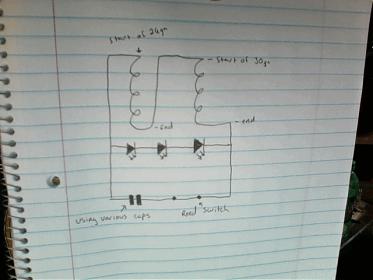

Can you give us a bit more detail on how your bifilar is wired? One wind is series connected with the other wind but which direction?
Thanks Zooty
This coil was one I wound up to run an SSG, so it's 150' of 30 gauge and 150' of 26 gauge. the way the coil is oriented as I am using it, the winds are CCW facing the rotor.
I hope the diagram I uploaded helps, it's one of the first I have drawn from scratch
I have marked the ends of each coil as start and end. not sure how well it came out in the photo after it was uploaded, so I just wanted to point out that is what I wrote in
also, I messed around a lot with positioning last night, and I did notice that when I pulled the coil and switch away, the rotor did speed up some. it wasn't much, but I am getting some drag...
I think why i didn't notice it before is when I am putting the reed switch in, it will slow the rotor down until I get the position right, then it speeds back up.
I must not have moved both at the same time before last night, so I never noticed the very slight drag on the rotor.
when i have the switch in the wrong place, the rotor slows quite a bit, and the LEDs either blink or don't come on at all. once it gets close to the right position, the LEDs will go to a very very fast blink, nearly imperceptible.
when everything is in the place where it all likes to run, the rotor is very nearly full speed (as I now know, sometimes i get impatient and post before I have done enough testing
) and the LEDs appear to be steady on, though I am sure they are just blinking faster than my eye can catch
hope this helps understand my ramblings a bit
if needed, I can upload a video, just let me know
thanks
N8

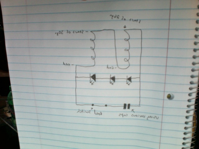

edit: ok, I checked the diagram I uploaded and it is backwards for some reason
I used my comps built in camera, and it must have inverted the image...
I will just flip it and re-post, make life easier on everyoneThe absence of proof is not proof of absence
