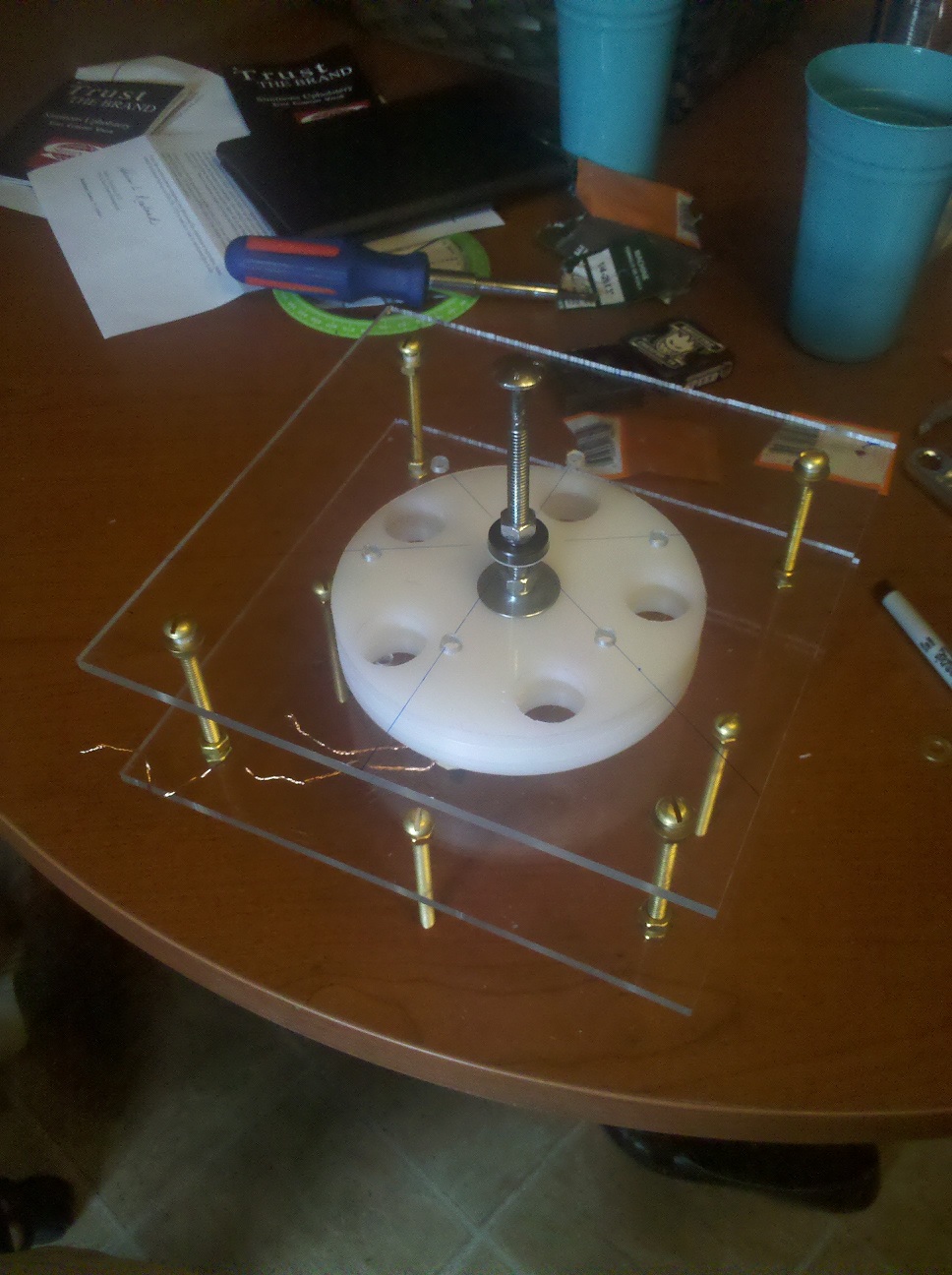

Greetings,
Here is my prototype based on RomeroUK's, Muller type dynamo. I did not wish to post this in a Muller replication thread as this forum already has one. because the nature of the device may be nothing at all similar to the Romero build. Once I have a device that more closely mirrors Romero's specs then I'll post in another thread.
I am aware that there are 5 magnet positions on the rotor. Romero's had 8. This is only a testing platform to get the basics down for the device. As well as be a test bed for a few ideas I've had floating around as of late. Such as drive circuits, coil shorting, and honestly just the basics before I wind 20 coils without knowing how it works. etc...
I can list all sizes of every component if people wish when there is data to present. But just the basics are:
Stator plates: 225.42mm. clear acrylic
Rotor: 145mm diameter. Made of cutting board material.
Magnets: (not installed yet) 1''x3/4'' N48 neo cylinders. Going to try to get them slightly pressed in rotor. Will cover both sides of rotor with 1/16 in lexan mounted with brass screws, for protection.
Coils: total of 6 coil pairs. sewing bobbin forms, 5 wire litzed (by hand by me) total .8mm diameter total when litzed. not many turns. 75 feet of litz wire made 6 coils.
Core: .25 in choke inductors from radioshack.
Bearings: high speed skate bearings.
Prob need to find stainless for rotor shaft. Just regular steel bolt for shaft right now. But used brass as much as possible to decrease strays.
