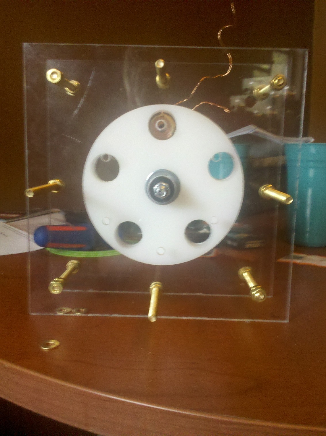

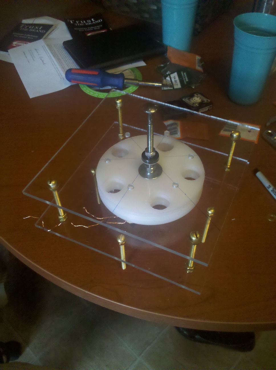

    Here is my prototype based on RomeroUK's, Muller type dynamo. I did not wish to post this in a Muller replication thread as this forum already has one. because the nature of the device may be nothing at all similar to the Romero build. Once I have a device that more closely mirrors Romero's specs then I'll post in another thread.
    I am aware that there are 5 magnet positions on the rotor. Romero's had 8. This is only a testing platform to get the basics down for the device. As well as be a test bed for a few ideas I've had floating around as of late. Such as drive circuits, coil shorting, and honestly just the basics before I wind 20 coils without knowing how it works. etc...
    I can list all sizes of every component if people wish when there is data to present. But just the basics are:
    Stator plates: 225.42mm. clear acrylic
    Rotor: 145mm diameter. Made of cutting board material.
    Magnets: (not installed yet) 1''x3/4'' N48 neo cylinders. Going to try to get them slightly pressed in rotor. Will cover both sides of rotor with 1/16 in lexan mounted with brass screws, for protection.
    Coils: total of 6 coil pairs. sewing bobbin forms, 5 wire litzed (by hand by me) total .8mm diameter total when litzed. not many turns. 75 feet of litz wire made 6 coils.
    Core: .25 in choke inductors from radioshack.
    Bearings: high speed skate bearings.
    Prob need to find stainless for rotor shaft. Just regular steel bolt for shaft right now. But used brass as much as possible to decrease strays.

        Thanks folks. Coils all wrapped will include their photos as soon as I get them positioned. 142857, sorry I missed your call. as you can see I was tied up trying my hardest to get everything measured 3 times and cut/drilled once. LOL

          for fixing magnets in place, you can slide them in with epoxy. That's the easiest way, and guaranteed to hold.
          I do not think that a steel shaft will negatively affect the performance of the generator, because it is quite far from the field of the magnets, and in the center far from everything else, so do not unnecessarily spend on a non-magnetic shaft.
          The important thing is to be sure that the rotor absolutely cannot wobble on the shaft...
          Good luck !
          P.S. Please correct the title of this thread.

            This is just a test setup. Due to the terrible price for neos these days im am looking to not permanently mount these magnets into this particular disk. I have plans for a ten magnet 11 coil setup in the near future. as soon as I get the basics of a few theories down.

                  Update:
                  Total failure!
                  This rotor was doomed from the start. I have learned so many things not to do with this build. Magnet spacing is way too close I believe. there is virtually a total north pole around the entire rotor. 1X.75 neos are way to powerful for this small of a rotor.
                  If anyone knows what is the ideal spacing for magnets of this magnitude would you please let me know.
                  My coils: My coils were Litzed by me. 5 strands of (now I think) way too thick wire. My resistance was in the kOhm range. Well at least thats what my Lc meter was saying. I have no reason to doubt it. The inductance for these small coils was in the micro Henry range. Even with the cores. I could not get a Bedini to trigger with these coils whatsoever. Prob a combination of coils and too strong magnets. definitely hall switching unless anyone knows the secret to trigger a bedini circuit with powerful neos. I have only ever used ceramics and small neos.
                  So next is smaller strand wire. more turns and bigger bobbins. Bigger rotor with larger spacing between magnets.

                    As far as neo's and a trigger winding, it should trigger much easier than with ceramic magnets. I just built a window motor with 4x1/2x1/4inch N45 neo's and it needs 500k on the base so that the power transistor does not draw too much current. Even with a 4.6ohm trigger winding i still need 20k+ on the base. I dont think neo's are the problem. Also, if you have a core, there is more current there. The only thing i can think of is that they are too close together and your not getting a switch. If they are too close, you could do a n/s/n/s and use the closeness to your advantage. Not only will your coil push on every pulse, it will attract the next magnet (after tdc only)
                      I do like how you're not giving up
                      Neo placement is trial and error, something to get a feel of, experiment with scruffy builds, just to see where you can and should place the magnets you have. You may need just 4 or may need 6 or even 8 on a rotor. Through those trials, you'll get a better idea of how much distance is required to form a 'virtual pole', the switch the Hall sensor needs. Onward from that, you'll know the size of rotor that can then go forward as the Muller machine build
