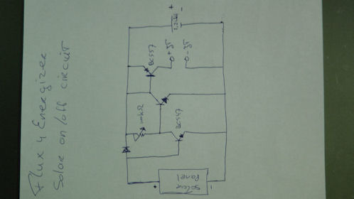

      Here is the Solar "ON" "OFF" switch circuit i thought up:
Name:	Solar on_off Circuit.jpg

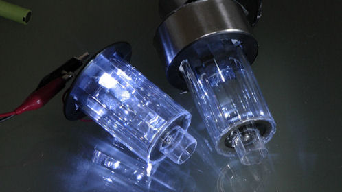

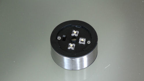

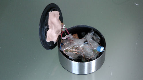

      And some building PICs and a test action foto
Name:	S-BWJT Inside.jpg
Name:	S-BWJT LED View.jpg
      If someone has a better Solar "ON" "OFF" switch circuit please let me know.
      The circuit works, but there is a downside with it.
      When you have tuned the JT to the right amp draw vs light output and you hook up the solar switch circuit the LEDs turn a lot dimmer.
      When i tested the JT circuit the LEDs were blazing at a amp draw of 16ma.
      But now the LEDs are dim
      If anyone has an idea i would like to hear it.
