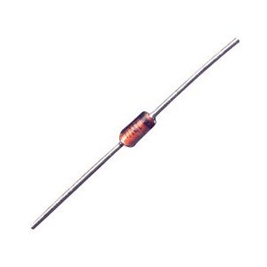

Building one up now that I hope shows flexibility of build. It uses a KN2222A, a 1N4148 diode instead of the LED across Emitter and Base and a Hall sensor that came off the very fan assembly that formed the rotor.
