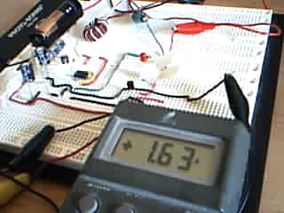

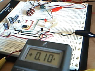

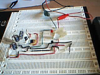

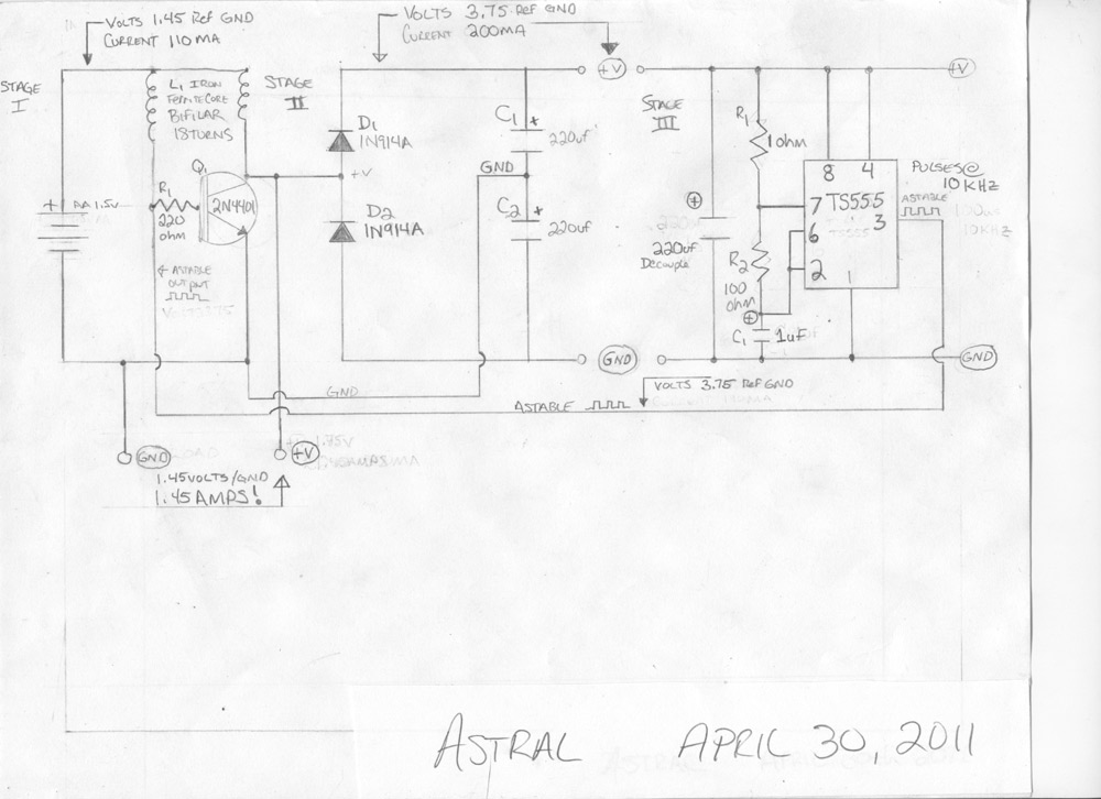

I did do a Rebuild with a N555 and some fast Diodes. My Power Source is a Powersupply, where it shows, what it consumes.
But it did not work for me. I can read at the Points you are refering too 2,1Ah,
but only with the low Resistor on my Meter for mA.
When i plug it into the 10Ah Resistor, it only reads 0,2Ah.
At the same time, as i put this Load on it, the Power supply shots up with the consumed Amps to 2,2Ah.
I did try a 5W/12W Bulb also and it consumed at 4V still 0,2Ah more.
It looks pretty 1:1, what it takes and provide for the Load.
So i assume you take it from your Batterie. Some of them have a Capacity from 2Ah. So you may can run it under heavy Load one Hour or 2.
But when you would connect a 5W Car bulb on it, it would not run to much Time.
The 2Ah what it does reading seems more is a measurement error on the Multimeter.Theorizer are like High Voltage. A lot hot Air with no Power behind but they are the dead of applied Work and Ideas.
