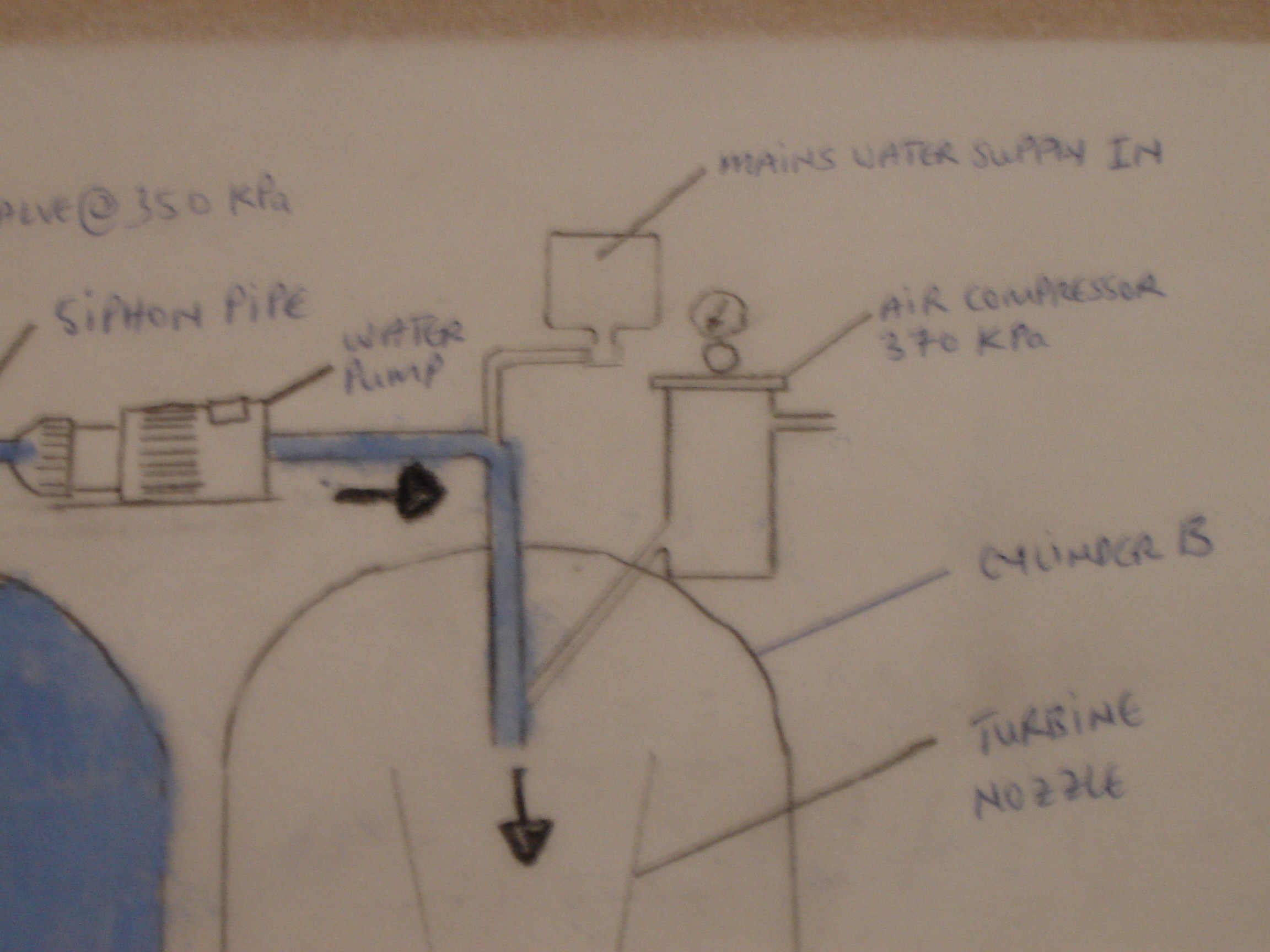

    Two Cylinders A and B, 25m high and 1m in diameter, stand side by side.
    Cylinder A is 90% full of seawater of density 1020kg/m3. It also contains approximately 10% by volume of castor oil (density 961kg/m3) which floats on top of the seawater. A small air gap is left at the top of cylinder A and a pressure relief valve sits at the top of cylinder A.
    A siphon of diameter 0.12m leads from the top of cylinder A down into cylinder B. An electric pump primes the siphon and begins fluid flow into cylinder B.
    Cylinder B contains only air to begin with, but there is an impulse turbine connected to an alternator motor at the base of cylinder B.
    A 3m space at the bottom of tank B (underneath the turbine) is needed to allow tailgate oil to accumulate without interfering with the movement of the turbine.
    The siphon (the short end of which ascends from the oil on the surface of tank A) has its longer end in Cylinder B, so that the longer end of the siphon allows oil to flow into tank B and strike the turbine.
    The flow rate of the oil is 1 cubic metre per second and it falls 20m (after exiting the nozzle at the long end of the siphon) before striking the turbine.
    An electric pump is used to prime the siphon flowing at a flow rate of 1 cubic metre per second. The pump consumes 30kW but requires only pulsed power because once the siphon has started working, it will continue working without help from the electric pump until the level of working fluid in tank A drops below the input nozzle of the siphon.

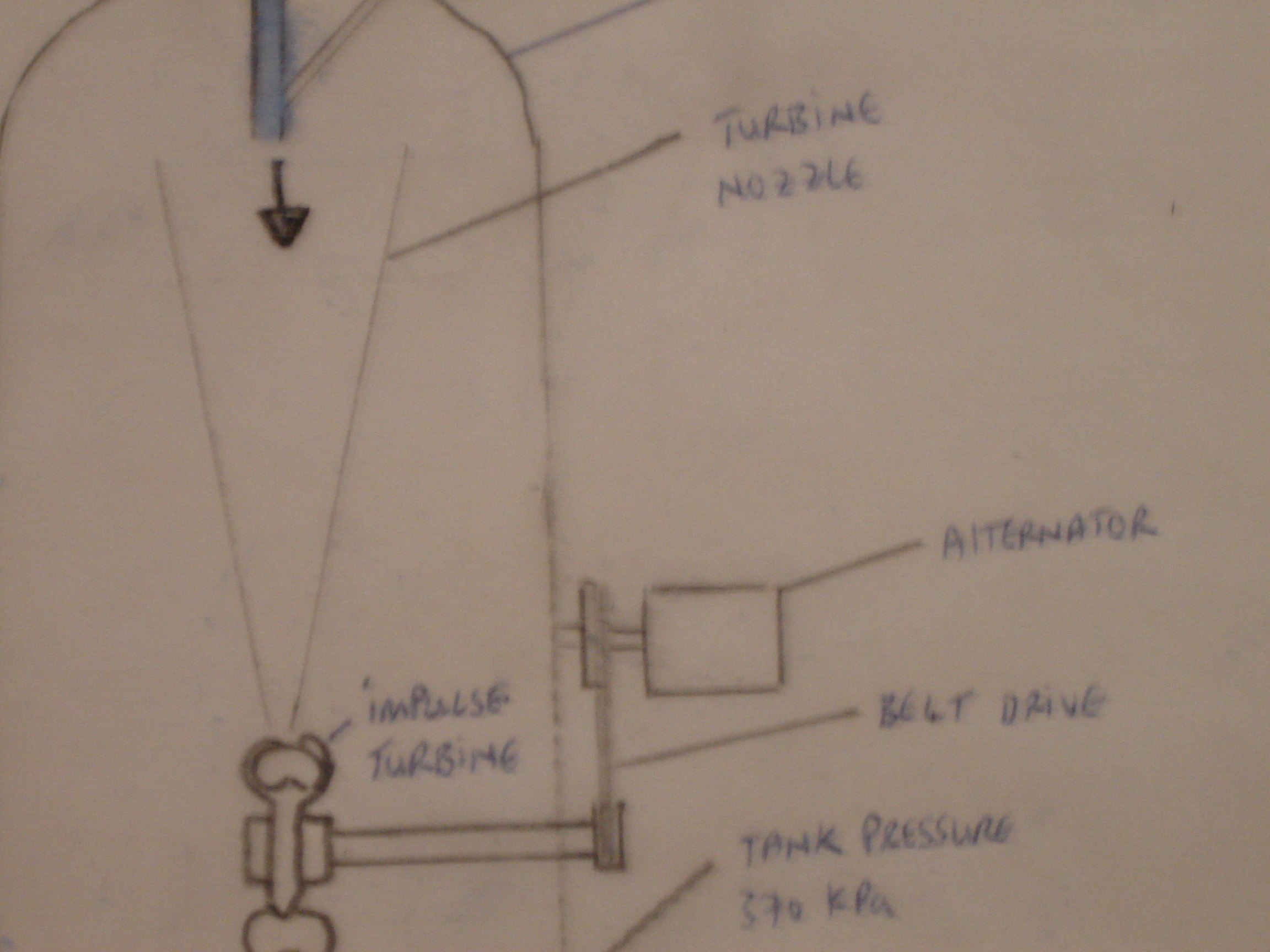

    We should be able to calculate how fast the turbine will rotate just from knowing the value of Fjet (which we calculated to be 10,006 Newtons) as well the turbine diameter and other variables we established earlier.
    I have chosen to use a Pelton impulse turbine of diameter 0.9 meters.
    The equation for determining the mechanical power output in watts of a turbine is as follows:
    Pmech (watts) = Fjet x Njet x pi x h x w x d / 60
    Explanation:
    Pmech = 170,000 watts (from the first calculation of maximum power output)
    Fjet = Force in Newtons of the water striking the turbine = 10,006 Newtons (calculated above)
    Njet = number of water jets = 1 jet nozzle
    pi = 3.141592654
    h = efficiency coefficient (unit-less fraction between 0 and 1). This is always going to be a figure between 0.69 and 0.94 for Pelton turbines. The larger they are, the more efficient they become, so 0.85 efficiency for a large turbine is an acceptable estimate = 0.85)
    d = pitch circle diameter of the turbine in meters (this will be a slightly smaller diameter than the outer diameter of the turbine = 0.87m)
    w = rpm (here not rad/s) which is the mystery value
    The mechanical power output in watts is going to be approximately the same as the electrical power output in watts (if we make allowance for heat dissipation and the inefficiency of components other than the turbine itself which we can do at any later point).
    Accordingly, applying the Pmech equation:
    170,000 (watts) = Fjet (10,006 Newtons) x Njet (1) x pi (3.141592654) x h (0.85) x w (mystery value in rpm) x d (0.87m) / 60
    = 10,006 X 1 X Pi x 0.85 x RPM x 0.87 / 60
    = 23246 x w / 60
    170,000 = 23246w / 60
    170,000 = 387.4333w
    w = 438.78 RPM
    So the RPM figure looks reasonable and the turbine should last more than a few months.

                My most recent calculations (and revised system specifications) are as follows:
                We have two 30m high steel cylinders 1m in diameter.
                Tank A is full of seawater. Tank B contains only 10% by volume of seawater. An impulse turbine is placed at the base of tank B above the water line. Two pipes connect the cylinders. An upper siphon leading into tank B from the open surface of tank A, and a lower connecting pipe leading from the base of tank B to the base of tank A. Water flows from tank A into the siphon by means of a water pump. The water enters the siphon and is accelerated by compressed air from the air compressor before it leaves the siphon nozzle. This water strikes the impulse turbine 25m beneath with a flow rate of 1m3/s.
                The tailgate water is ejected from tank B into tank A by means of higher pressure in tank B. A pressure relief valve in tank B prevents pressure exceeding 501kPa. Tank B pressure always exceeds tank A base pressure (401kPa). Tank A surface pressure is always Patmos (101325Pa). The fluid recirculates and the turbine produces electricity.
                Summary:
                Steel Cylinder A: Height 30m Diameter 1m (full of seawater)
                Steel Cylinder B: Height 30m Diameter 1m (3m depth of seawater)
                Pelton Impulse Turbine: Diameter 0.9m (PCD 0.87m) (Efficiency 0.9)
                Abac Genesis 1108 air compressor (11kW 800kPa @ 1.67 m3/m = 0.027833 m3/s)
                ESP-10 150 siphon water pump (37.77kW 1m3/s flow rate)
                Drawn Copper Siphon Pipe: Diameter 0.38m
                Drawn Copper Lower Connecting Pipe: Diameter 0.38m
