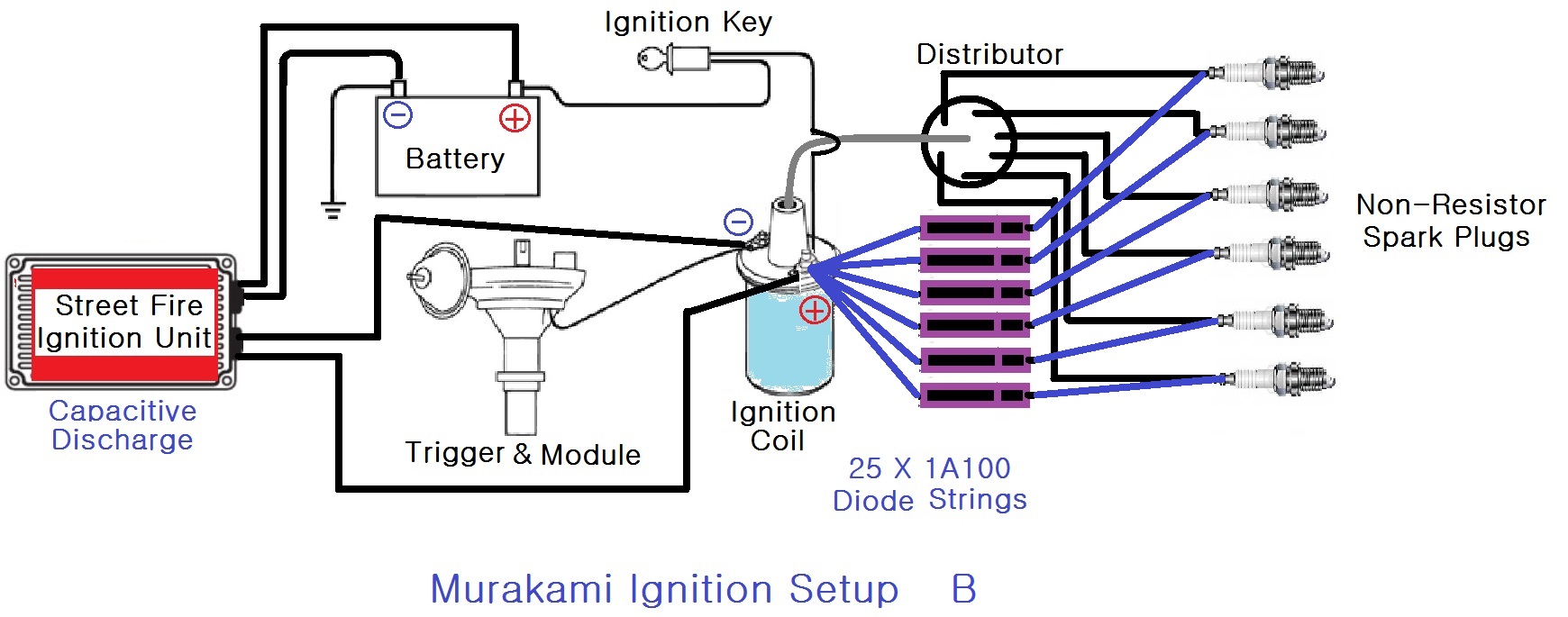

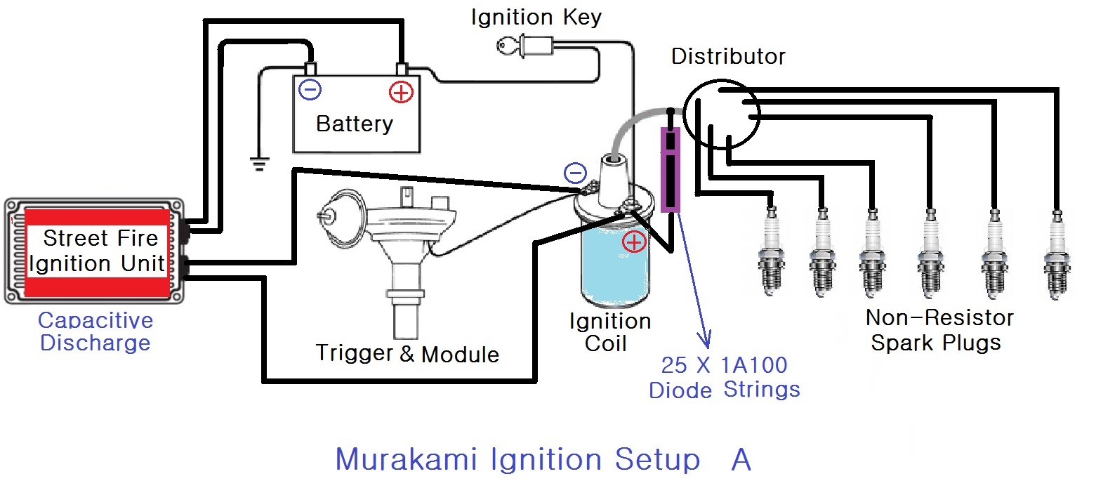

Is this setup right ? A or B ?
Hello !
This post for Mr. Aaron.
I read your book "The Ignition Secrets".
After I read your book, I try to install the plasma setup.
But I have a question regarding the diode string hook up method.
I upload two kind hook up diagram that A and B.
Which ways is correct hook up method ? A or B ?
A has only one diode string for plasma ignition and
B is hook up the diode string each spark plugs.
Please help me right method.
Thank you.
Luis
