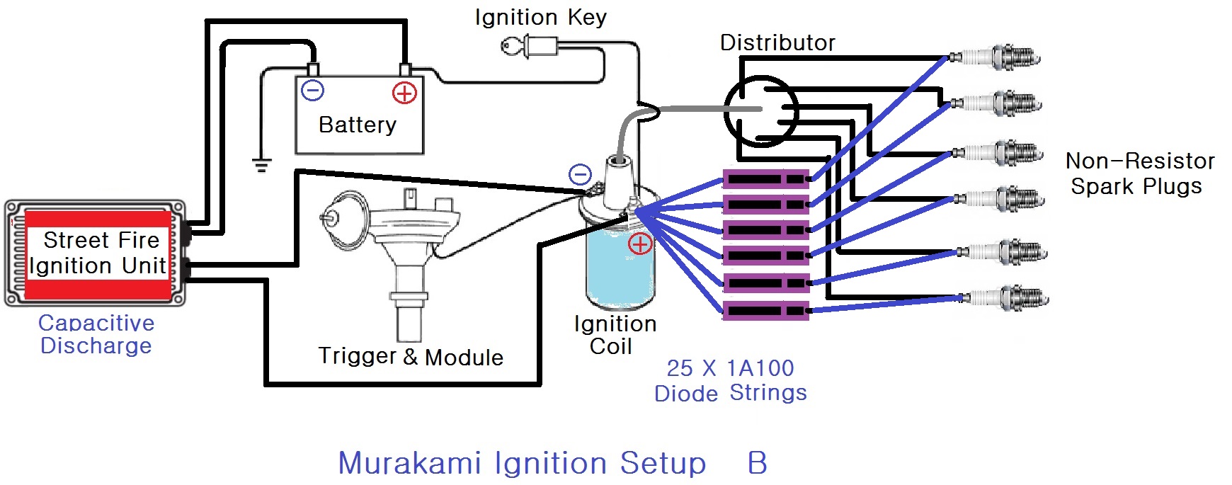

                Is this setup right ? A or B ?
                Hello !
                This post for Mr. Aaron.
                I read your book "The Ignition Secrets".
                After I read your book, I try to install the plasma setup.
                But I have a question regarding the diode string hook up method.
                I upload two kind hook up diagram that A and B.
                Which ways is correct hook up method ? A or B ?
                A has only one diode string for plasma ignition and
                B is hook up the diode string each spark plugs.
                Please help me right method.
                Thank you.
