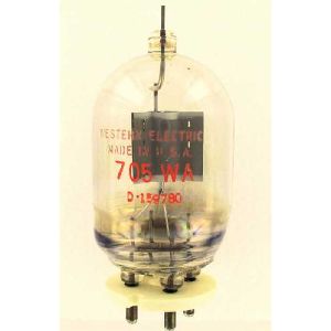

                  I got the tube 705WA but need help on how to connect it as this is my first tube and need help not to destroy it.
                  I find a pdf file with data and cant understand how to.
                  What iam guessing is the points 3 and 1 are the filament and those must be powered with 5Volts/5Amps.Is that right?
                  What should connect on point number 2 and 4 and is the top metal "hut" on the tube used in any way?

                    These are nice old buggers,
                    I just spotted a matched pair on eBay for about $40.
                    Most are only aware of lower voltage units like the 5U4GB, etc.
                    A lot of rectifier tubes use one of the heater terminals as the cathode lead also,
                    but this design uses a dedicated cathode lead that is also a center-tap on the heater.
                    So yes, heater voltage goes to one 1 & 3,
                    2 is the center tap on the heater AND cathode,
                    and 4 has no connection on it.
                    (See attached pinout pic)
                    So measure the three active leads for the highest resistance reading,
                    that would be terminal 1 and 3 for the heater.
                    The resistance to the remaining pin will be half of that reading
                    from both heater pins because it is center tapped.
                    I state this to you, so you can confirm internal wiring,
                    and blow out your pretty new toy, heheh...
                    That pin (2) is the cathode, the cap on top of the tube is the anode (Plate)
                    You know the silicon equivelant as this:
                    Anode ---|>|--- Cathode
                    It takes five volts direct current at about five amperes to pins 1 & 3 for the heater,
                    that is the specifications for this, back in the day of type "A" 90-volt plate batteries.
                    But you can use AC too if you bring it up slowly and determine the correct amount,
                    I suspect at that heavy a filiment it will be about 3.75-VAC for proper operation.
                    Put a steady 5-VDC in while in a dimly lit room to get your reference visual,
                    then match that with slowly inceasing AC voltage to match the brightness.
                    The filiment will last a lot longer on AC...
                    Put your alternating voltage to be rectified to pin 2 on the base,
                    collect your rectified positive voltage from the "top-hat" pin (Plate).
                    These will take about 30-KV peak inverse voltage across it,
                    and supply a hefty 100-milliampere of rectified current.
                    You may see ratings as high as 400-milliampere (0.4-Ampere),
                    but try to keep it under 150-milliampere for tube longevity,
                    and under 360-milliampere for the better three pin unit...
                    Also, the four pin has a full top hat the uses the later standardized cap,
                    and of course the standard large-pin'd obligitory four pin rectifier base.
                    But they can be found with a three pin base and a wire lead cap instead,
                    with a thoriated tungstene cathode from General Electric (DLA MIL-PRF-1/1159D).
                    (See attached Alternate Packaging pic)
