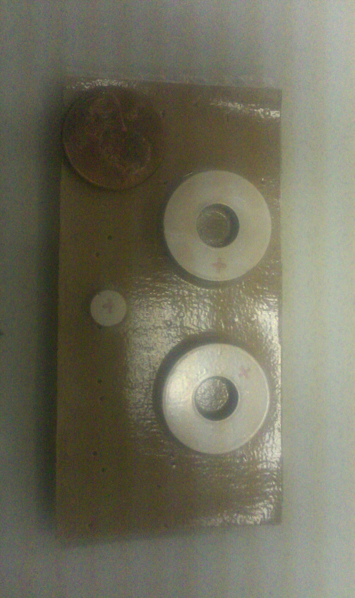

                piezoelectric transducer's have arrived! I have attached a pic.
                -Altrez

                  Couple of questions
                  Hi altrez,
                  I have a couple of questions if you don't mind. What frequency are the piezo transducers designed for? Most of the piezo transducers I am familiar with only put out a strong signal on a very narrow range of frequencies. Earlier in the thread someone mentioned a frequency of around 47 khz. I am not sure where they got that as I have not read all the background material yet. According to the specs on the amplifier you ordered it is only rated to 20 khz before the output starts dropping off. I am afraid that at 47 khz your output may be down to almost nothing. If you are going to be using a power amp you can probably build a small oscillator circuit that can be tuned across the range you want and then you wouldn't need that expensive signal generator. I hope I am not discouraging you. You were asking for comments and these were some of the things I was wondering about as I was looking at your thread.
                  Take care, Carroll
                  • #24
                    Hi altrez,
                    Take care, Carroll
                    Hello citfta,
                    Thank you so much for taking the time to comment! The ones I am using have been tested up to 74.51 kHz. I only need between 20-25 kHz so the amp should give close to full power at that frequency.
                    When I move deep into the larger units a yet untested area in this field I will need to build a custom AMP that does not filter any of the output.
                    I have thought about building a small oscillator but really need the generator for some other projects as well. Once I can confirm what I need then I can simply build one near the right frequency for my reaction chamber.

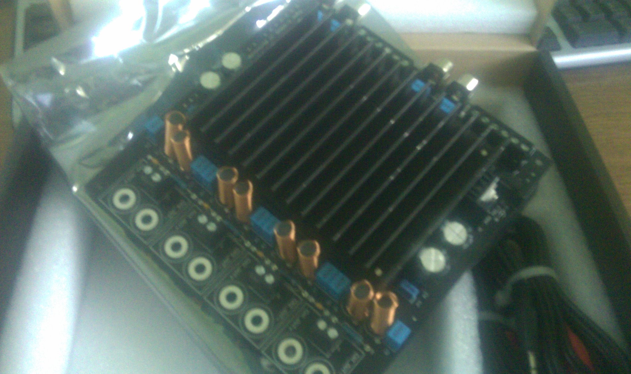

                                Starting to get some parts together guys. Here is a pic of my amp. With any luck I should have the glassware in soon.
                                -Altrez
