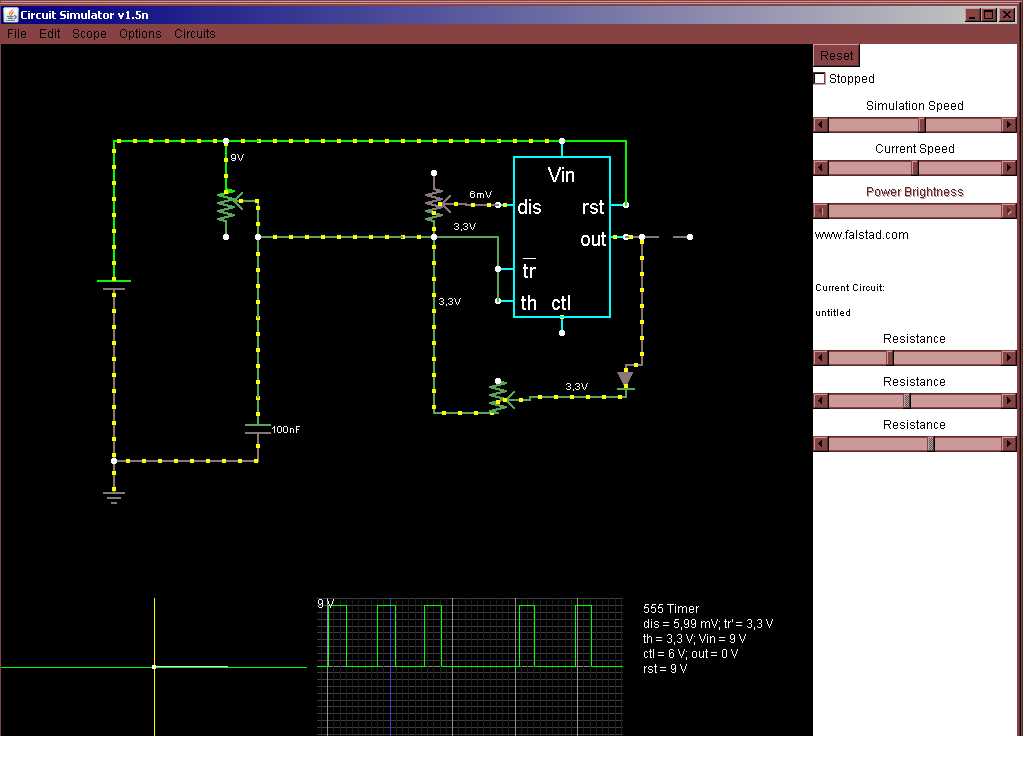

I build up a Timer Circuit, what runs from 500hz up to 4khz,
I can still adjust to a low duty cycle and frequency, even when it is some tuning around at some cases.
A Meter for measure the Frequency is very handy for that, or an Oscilloscope for the Duty Cycle.

Double click at Circuit.jar at this new Folder, and the Applet with a standard Circuit comes up.
Click right top at the Menu at File-Import. A Empty Box comes up, and past this Digits in.
Now you can see the Circuit and how it runs, when you change one of the 3 Resistors right Side below.
Optional you can place another 1K 5k or 10K Potentiometer to R1 Left Side top in Series, for a better fine Tuning.
Right side Top are Levers for the Simulation Speed.

R1 50k Potentiometer
R2 10k Potentiometer.
R3 10k Potentiometer.
Unpoled Capacitor 100nf or equal.
Optional 1k, 5k or 10k in Serie with R1(50K).
And dont forget to connect Pin1 with Ground and the one Side of the Capacitor,
which is assumed at the Applet.
