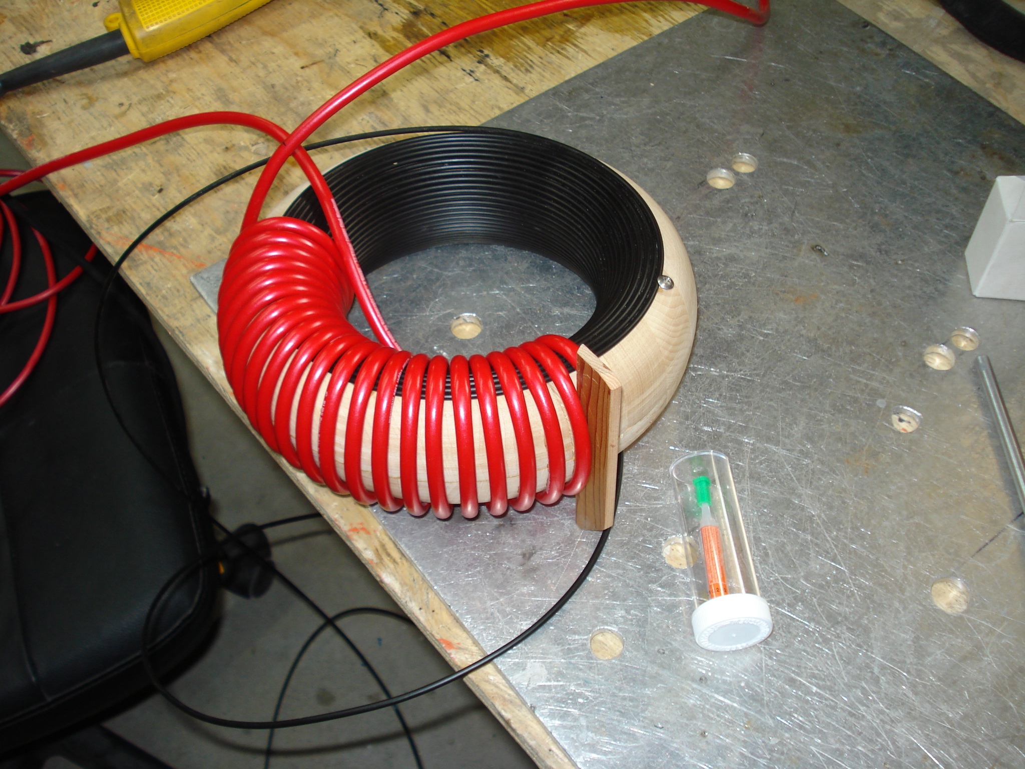

I'm currently building a toroid to power my hho cell. See pic. It a tedious process, I superglue all the windings.
The red windings will cover the whole circumference when finished.
It is perpendicular wound, wood core toroid, with an elliptical section.
The red wire is copper clad aluminum. The black wire is copper clad steel.
The idea of the steel wire was to be have more inductance at a lower freq.

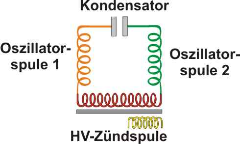

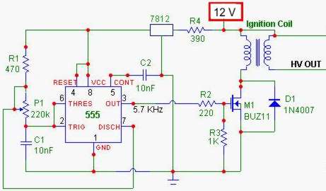

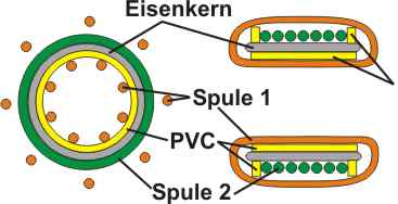

I took the inspiration of perpendicular wound toroid in german site that decribe the basic principle behind Daniel Dingle water car. I was thinking of simplifying the drive circuit by using a joule thief type setup instead of the occillaotr + Hv coil as described in the document.
