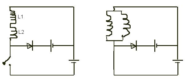

        assuming the equations work out the way they "look"....
        since L-total = 1/L1 + 1/L2 in parallel
        and L-total = L1 + L2 in series...
        then how about energising two coils L1 & L2 while connected in parallel, and allowing them to collapse (through a diode to a cap etc etc ) while connected in series?

                  attatched, charge & discharge circuits..though switching to change the coils from parrallel to series isnt in there.

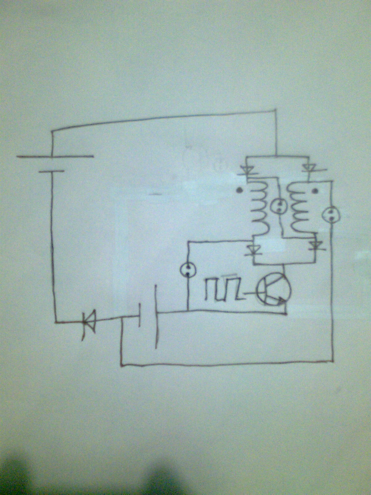

                      So i'm guessing this wouldn't work..

                        that concept can be placed in the first category. Changing inductance by windings.
                        You charge both coils and discharge their combined field with 1 coil. This like taking 2 coils one with x turns and other with 2x turns. You charge up the coil with 2x turns, then you open it's circuit and close the circuit of x turn coil. Yes the current will be 2 times higher than what was in the 2x coil thus energy would increase by factor of 4 due to that, but then the turns also decrease by a factor of 2, so energy would decrease by 4 times. Thus the net inductive energy remains unchanged. Because both are to the 2nd power in the energy equation.
                        Both current and turn amount are squared in inductive energy. So changing turns won't give you and increase. What aren't squared are area, length, and permeability.
                        This is for a solenoid inductor. Other shapes have other behaviors. For instance a flat spiral coil has a completely different behavior. But just remember one thing, you want an inductance change that is disproportional to the current change. If your inductance drops 2 times you current has to get at least higher than 2 times. If you can see this on a scope you have a winner.
