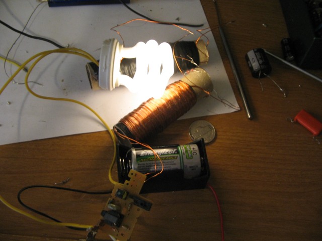

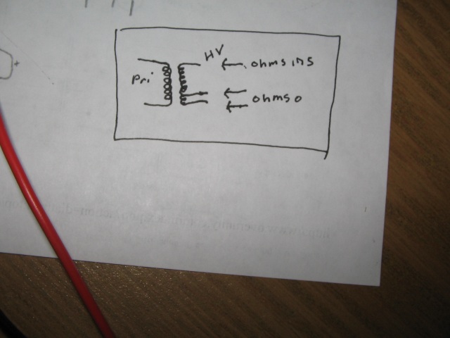

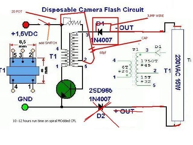

Hi bolt1, thanks for the circuit. Is the coil connected to transistor collector, is that the high ohm secondary of the fuji transformer or is it the coil on the top right, which would make more sense, thanks. Also I have a large ferrite cylinder core wound with an 18 gauge bifilar and a large 24 gauge secondary wound over it. It lights up any fluorescent with around 2 volts or better. Do you think the bifilar of this coil can serve the same function as the center tap transformer, if i just connect the ends of the bifilar and tap that, thanks.
