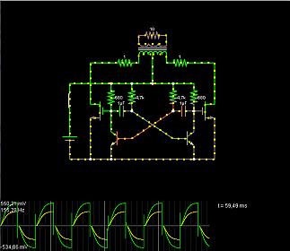

      • And here is a simulation
        FLIP FLOP SIM

                        • The French circuit replication
                          @KEhYo07
                          Thanks for posting that link to the SIM. I didn't get a chance to work with it is because I went ahead and built the circuit. I had all the parts except the transformer so I used the 12v one that I had on Xee2's circuit. The circuit ran good. The Xee circuit is much simpler but I do really like this "French" circuit. Here is a video of it running:
                          The French inverter circuit - YouTube
                          @dragon
                          It does run a little too fast. I didn't scope it but when I listened to it with my little radio you could tell that it was higher than 60 hz. The only real problem that I had with the circuit was the IRF510 mosfets from radio shack didn't work. I tried some IRF730 that I had and they worked fine. . This setup looks like a very good "put it in a box and use it" situation.
