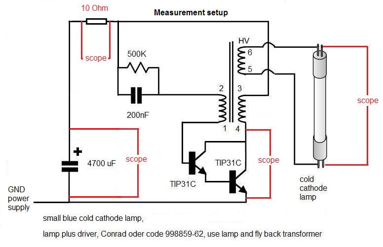

Ever since I saw your second video with that little CFL running away as you twirled it with your fingers----I wanted one. Well I had to change things a little but I have one now. I mounted the whole thing on one of those Electronic Goldmine camera units (took everything off but the transformer and transistor) and used just one 10,000uf / 10 volt electrolytic cap. Instead of the bifilar coil and diodes I used a .22uf cap and 470k ohm resistor in parallel. They go in place of the 220 ohm resistor on the board. I strung two extra wires off that to show the "finger touching " effect.
In the video the device is actually blinking but the camera really doesn't show it that well. The cap was charged with 9 volts and the CFL "blinker" will run about 4 minutes.
