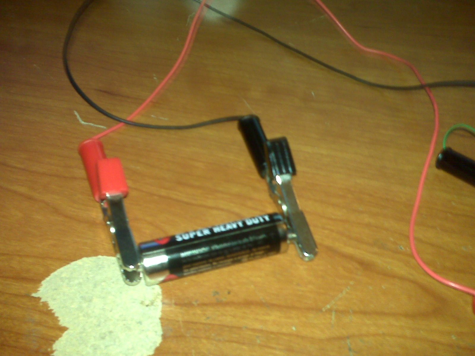

                • Ive developed a combo of parts that make it really easy to make a joule ringer for people who have never done it before. Ill be uploading pics tomorrow but here is the part list.
                  One "dead" battery
                  6 Led flashlight head
                  2 3/4 by 1/2 inch toriods wound bifilar 5 wraps
                  Tip142 transistor
                  thats it. The circuit draws around 44ma @ .95 volts
                  Ill upload a diagram in a few hours.
                  heres some pics to show that the led - can be hooked to any points in the circuit. The middle connection between the coils is grey to grey and orange to orange. grey on the second coil goes to middle leg of the tip142 orange to the left and ground on the right
