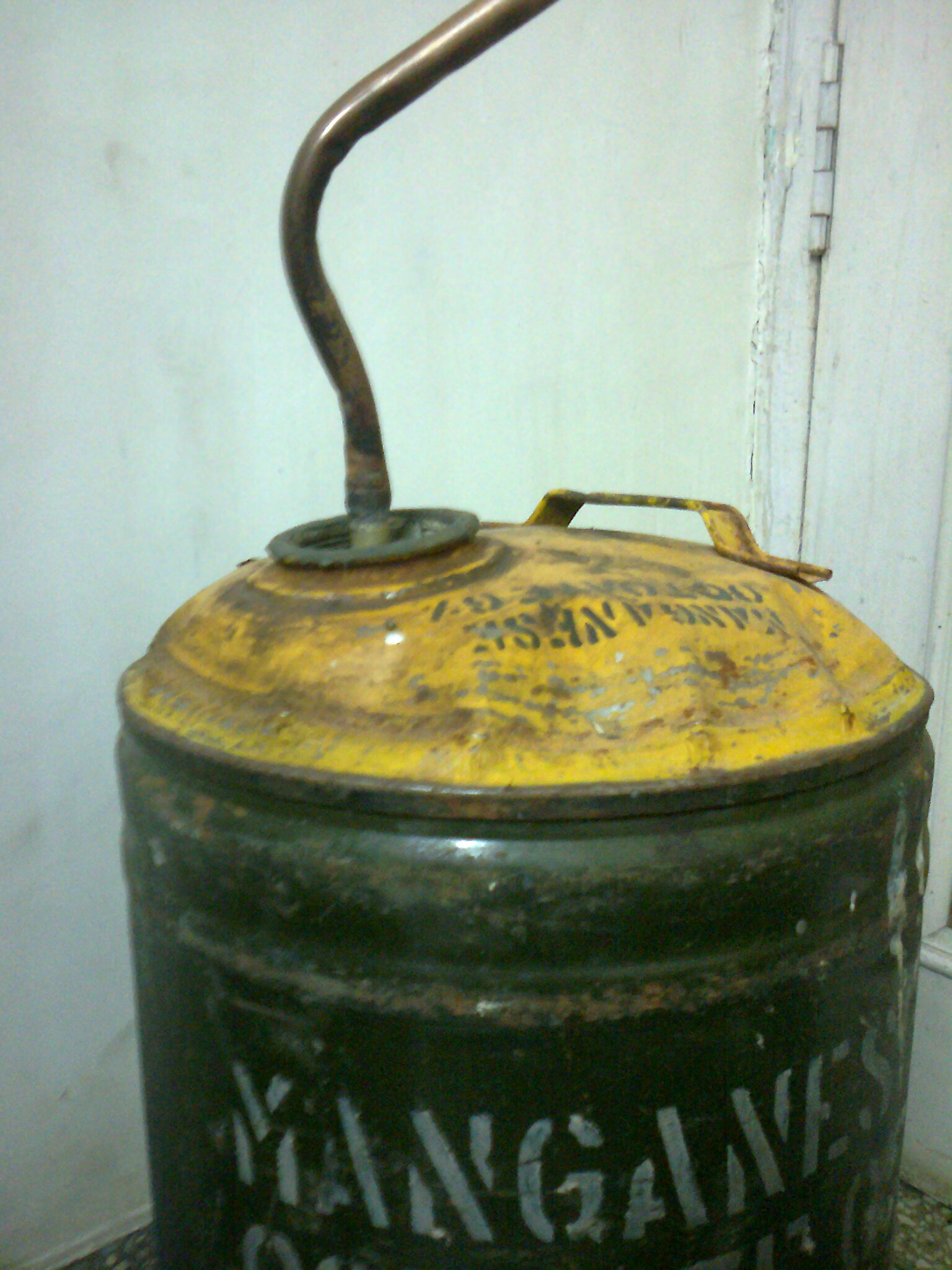

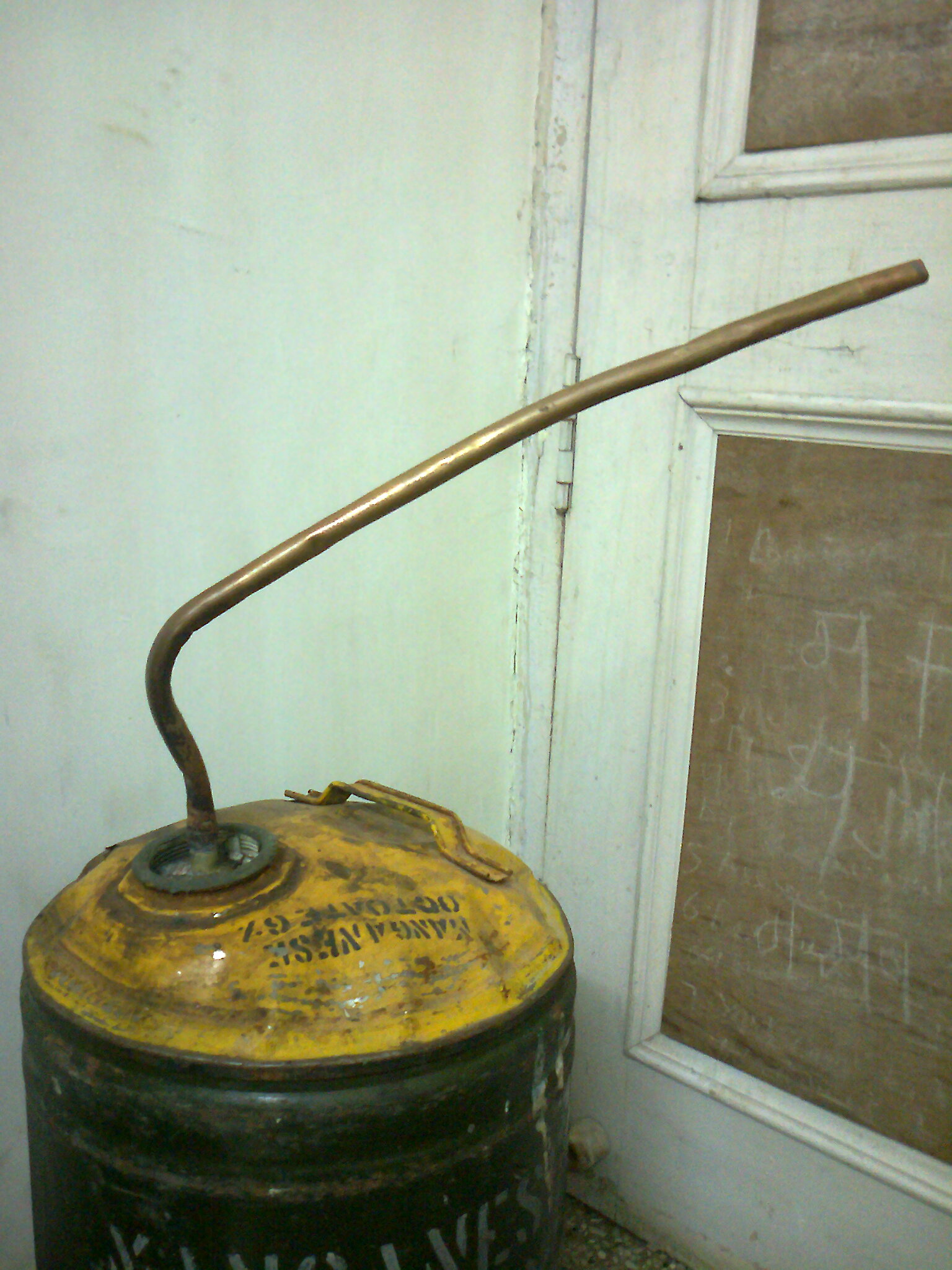

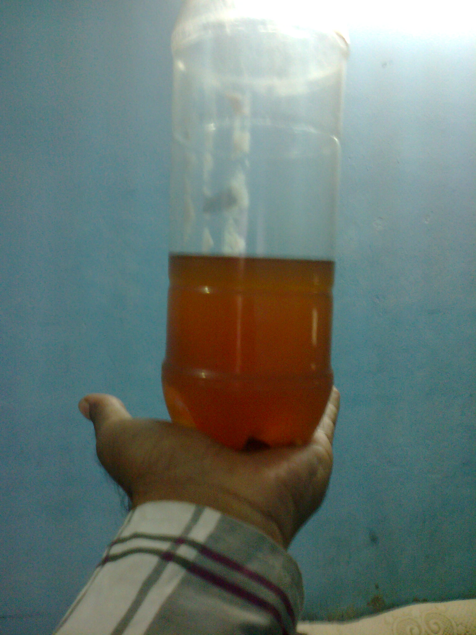

total weight of the plastic was 6 kg .I used an old model used kerosene stove(which I got after too much of searching as its sort of rare these days).After almost 1 hour I saw some steam coming out of the cap of the drum I seald with an sealant.After that though a lot of somke(or may be vapours)started coming out from the bottle filled with water but even after some 5-51/2 hours I was not able to get a drop of fuel in to water bottle.But as I replaced the kerosene stove with an LPG gas burner (for commercial purpose) I start getting fuel after some 5 mins.and with in next 2 hours I got around 1 lt of liquid fuel.And then I stopped the gas burner and I took the pipe that I put in to the water bottle out of it and just then I felt that the paint drum is going to blow off and I ran down the stairs and the paint drum which I used as my heating vessel got down from the burner stand and a lot of steam coming out of the condensing pipe with a lot of pressure.The paint which was flat from top and bottom got swollen from both the ends.I am posting the pictures of the drum after the incidence.
