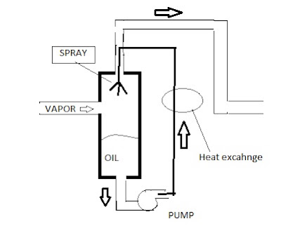

        • thoughts on condenser
          this condenser design is often used in industry - i thihk it is more efficient at cooling than shell and tube.
          it uses a quench loop to self cool the incoming vapors -
          you pump the liquid to a spray nozzle. and it is also pumped through a heat exchange to either cool or heat the spray fluid. in steady operation you could - in theory control the temperature of the loop.
          you could also pump it through a filter as well. The pump is sensitive because it is a hot / acidic / messy fluid with particles in it.
          i do not know if i will implement this design or not - sorry for crude drawing
